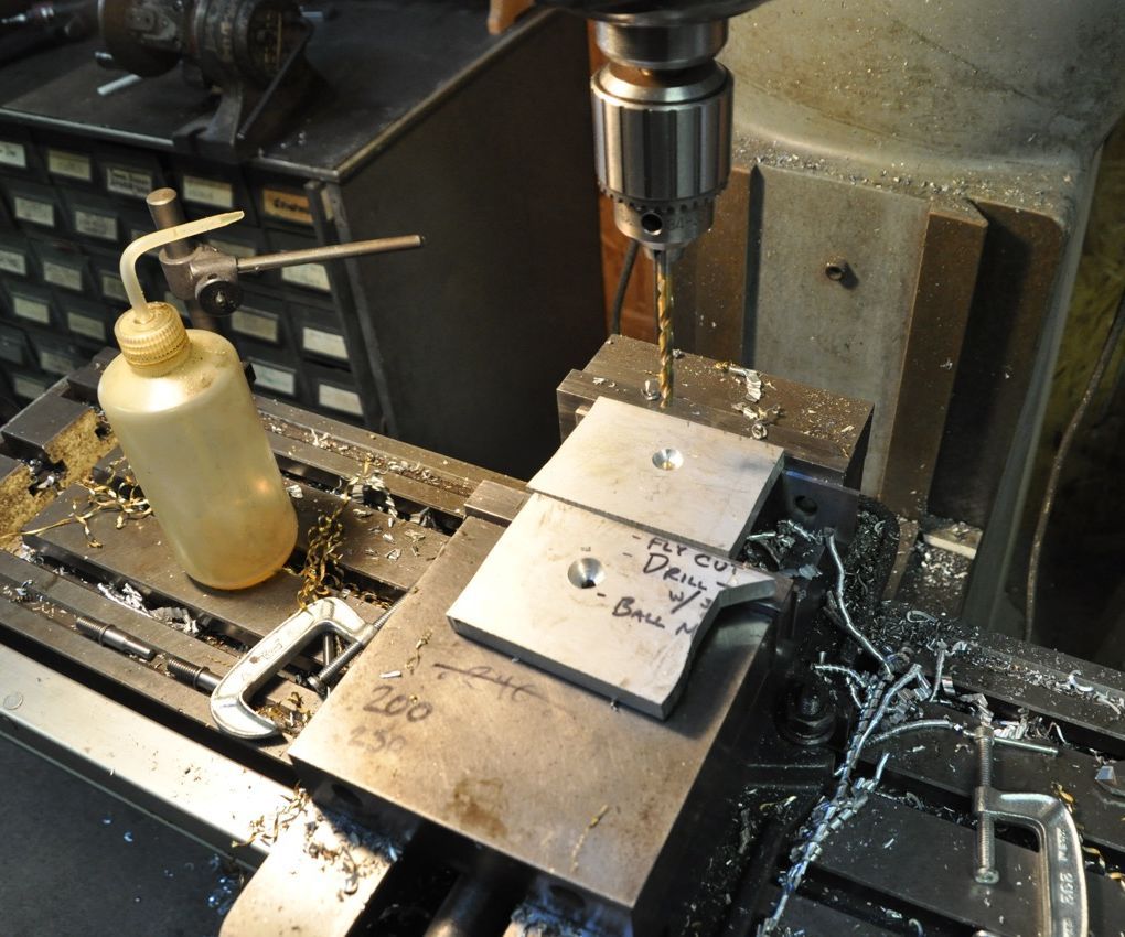

Step 2: Machining the Parts
Using a combination of manual and CNC machining techniques, I machined the parts from mild steel. Mild steel works fine, but chromoly or tool steel would work even better.
