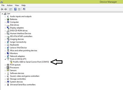

Step 2: Installing Windows 7 or 8.1 Drivers for Cloned USB to RS232 TLL Converter (UTC) With Prolific PL2303HX IC.
Getting these cloned, cheap UTC to work in Windows is a bit tricky. We need to have right drivers to get it detected in our Device Manager of windows PCs.
The Windows 7 or 8.1 drivers for cloned UTC with Prolific PL2303HX IC. can be found here. Download this zip file and extract to some known folder. May be these work also with windows 10 etc. but I have tried this only on Win7 , 8.1. I would be happy to know results if someone tries this on win 10. For Windows XP i used driver available here.
(following sequence is for windows 8.1 PC - similar procedure needs to be followed for other Windows versions).
1) Press Windows button of your PC and search for Device Manager
2) Open Device manager and expand Ports (COM & LPT) section. Insert UTC into USB port of the PC.
3) After sometime, if drivers for the UTC are not present on your PC, an error will be indicated by Yellow triangle next to "Prolific USB to Serial Comm Port (COMxx)".... Do not Panic.
4) Follow sequences as shown in my video starting here
5) After installation of drivers, Yellow triangle should disappear- note-down the COM port number for later use.
