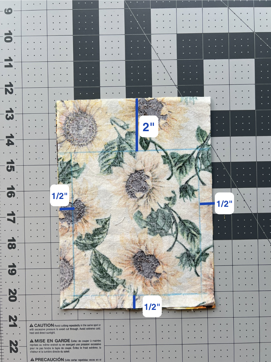

Step 2: Mark Fabric
With right sides of fabric together, take the fabric pencil and mark a line 2" from the top. Additionally, mark 1/2" from the left and right side of the fabric stopping where the 2" mark is placed. Lastly, mark 1/2" from the bottom of the fabric.

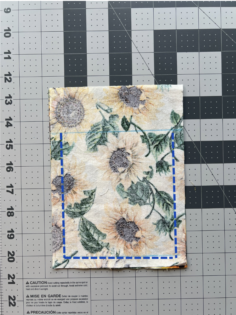

Step 3: Sew Sides Together
Using your sewing machine, sew a straight stitch with a 1/2" seam allowance sewing the left, bottom, and right side together.
