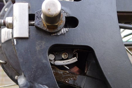

The NuVinci® hub is a continuously variable transmission (CVT). The hub's control ring can rotate freely over all positions, ranging from 12 o'clock (low gear) anti-clockwise to approximately 5 to 6 o'clock (high gear). When one of the shift cables snaps, the preferred position of the hub appears to be the low gear (i.e. low gear ratio), which only allows low cycling speeds. For riding more fast it is required to fix the control ring with its notch at 5 to 6 o'clock.
The next step illustrates securing the control ring in the high gear position using a hair tie. In this way it is more easy to get home or to reach a bicycle repair shop.
Step 2: Positioning the Hair Tie

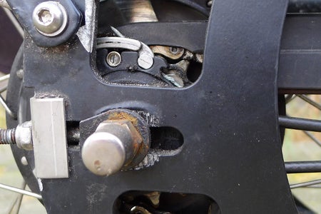

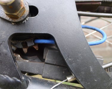

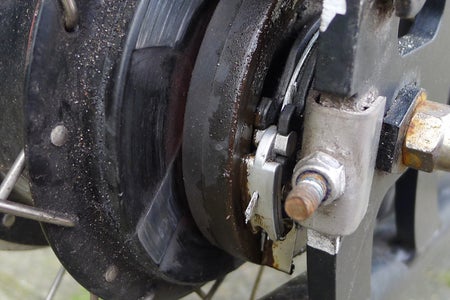

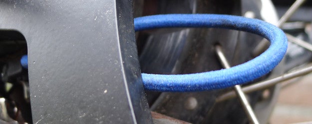

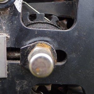

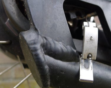

This operation should be performed when the bicycle is in a standstill position and is only easily possible when the construction is freely accessible (i.e. no hub cover in place). First, make sure that a notch is available for placing the hair tie. Remove the control cable if needed, see first picture. Hitch the hair tie in the notch as indicated in the lower-left picture. Wrap it around the frame and then fix it to the axis nut. If the hair tie is too long (i.e. the tension is too low), wrap it around the nut several times as indicated in the lower-right picture. Obviously, the shifter handle doesn't work anymore after this fix because the cables have been detached (at least one of them was broken anyway). After this fix you'll be able to ride only in the high gear. But as already mentioned: this is usually (at least in flat landscapes) more comfortable than in the low gear, which is the preferred position of the hub.
