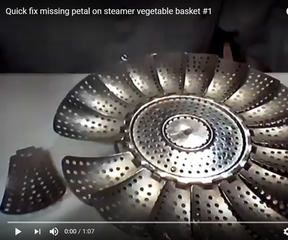

Quick Fix Missing Petal on Steamer Vegetable Basket
https://www.instructables.com/id/Quick-Fix-Missing...

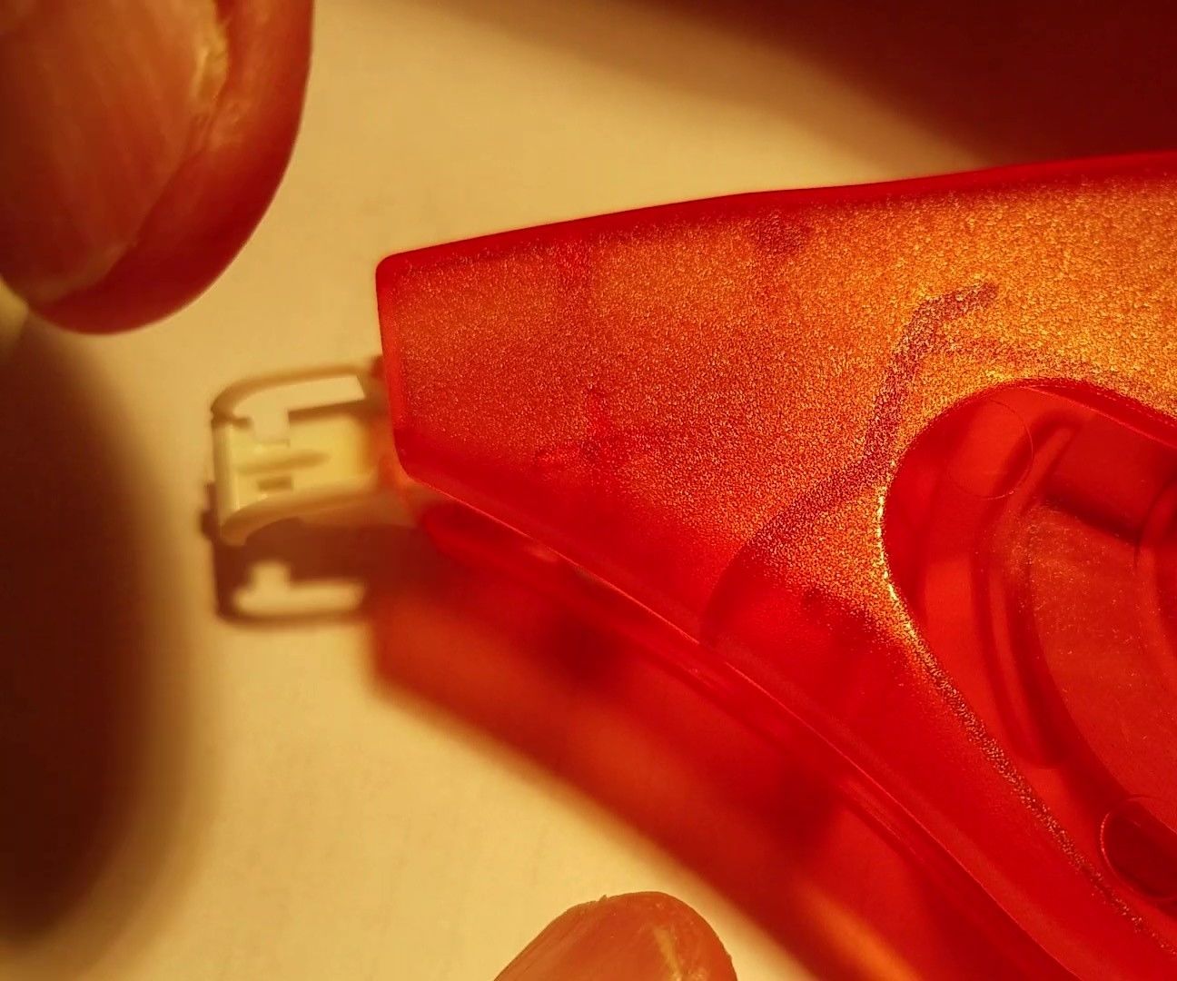

Quick Fix BIC Wite-Out Tape Dispenser White Out
