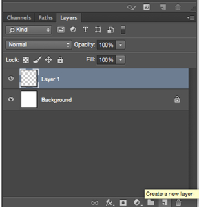

Layers are the building blocks of Photoshop and the key to properly editing your photos. Not only do they allow you to easily organize and customize your photos, but also provides you with the ability to test different designs and looks with ease. To describe layers in a visual sense one must imagine an artist drawing. The artist builds up a drawing by adding layers of shading and lines stacking each on top the other in order to create depth and detail, this is the same for Photoshop. The layer panel is on the right side of the workspace window. Highlighted at the bottom right is the create a new layer function. After every edit you should start working on a new layer in order to preserve the last edits you made. To make a new layer with your full image as the layer, click the new layer button, then on the top toolbar click Image>Apply Image and this will apply whatever is on your canvas and compress it into one new layer letting you work directly on that.

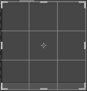

The Crop tool can easily change the composition of your photo using a function based off the Rule of Thirds. To use the crop tool, click the crop icon on the toolbar and the cursor will change to a reticle with a square crop symbol. Click and drag from one corner to the other to create whatever size canvas desired. Once the mouse is let go, the new canvas area is cropped, and the new area will be highlighted while the cut out portions will be darkened out until finalized. When happy with the new canvas size and position click enter and the newly cropped area is put into place effectively resizing. In the thumbnail you can see the Rule of Thirds grid.
To utilize the Rule of Thirds and the crop tool you should consider placing your focal point within or around one of the intersecting lines. This will strengthen the focal point, because the eye is naturally drawn to these areas.

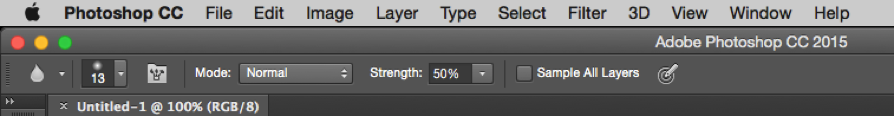

The blur tool is used to effectively create depth, and strengthen certain elements in your work. The Blur Tool selectively distorts pixels around the reticle at a strength of your choosing. To use the Blur Tool, click the blur icon in the toolbar, and again your reticle should change to a circle. This shows you what parts of the photo you will be blurring when clicking the mouse. To change the strength of your blurring use the top toolbar and highlight the percentage in the strength slot. 50% is the Adobe standard but feel free to play in order to get the best image in your situation. Then, click selective areas of your photo with the blur tool on a new layer to edit the sharpness.
