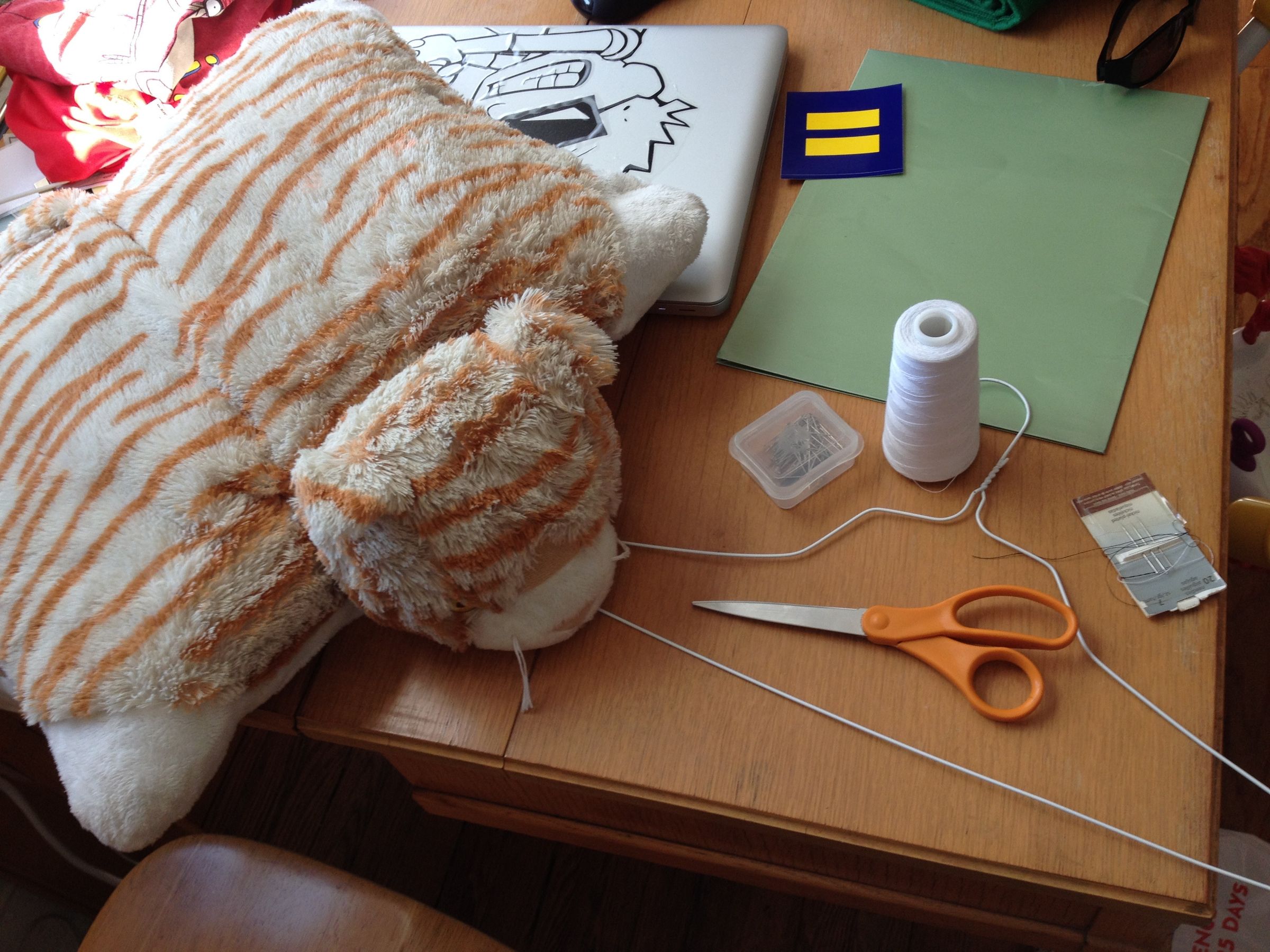

  1. 3" styrofoam ball (or whatever you want your head to look like)
  2. masking tape
  3. toilet paper tube
  4. fabric to cover head (I am using felt for this guide)
  5. fabric, buttons, etc for face and features
  6. fabric scissors
  7. regular scissors
  8. needle and thread
  9. sewing pins
  10. marker
  11. thick cardstock paper
  12. hot glue gun
