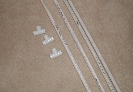

# three six foot tubes of 1/2" PVC (~$1.50 each)
# one bag of 1/2" slip elbows (not threaded) (~$3 for ten)
# one bag of 1/2" slip t-joints (not threaded) (~$2 for ten)

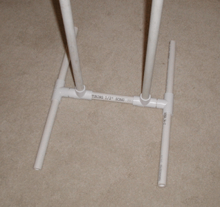

The base splays out in both directions to allow it to be weighted. I just used exercise weights or plates on the base.
The chest is made from three t-joints (joined with <2" pieces near the neck) and four elbows. If you don't glue the shoulders you can pose the arms.

Cement (gluing) is optional. The mannequin will stay together well if you take the time to push and lightly tap them into the joints with a hammer. If you want to take it apart, don't glue it, but be warned that the parts near the base have a tendency to rotate forward and backward once weighted so gluing these bits may be advantageous. Even with the base glued you'll still be able to take it apart for easy storage.
