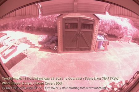

Edit Crontab to upload each minute the latest motion image
# m h dom mon dow command
* * * * * python /home/pi/QuickDoorCam/webcam.py

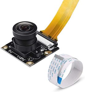

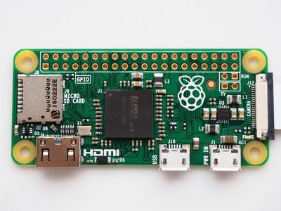

RaspberriPi Zero (W Model w/ built in wireless)
Webcam (fisheye FOV lens)

Get the webcam and the LED and the RPI ready to mount in the case
Mount the Camera throught the front hole
Install the LED through the small hole in the corner and place the RPI Zero and wiring inside the case

Configure Application to run correctly in settings.py config file
Find the file settings.py-example and adjust to your current settings
Enter your SFTP server and api.forecast.io credentials to get the weather subtitles working and the images uploaded to be viewed on the web.
