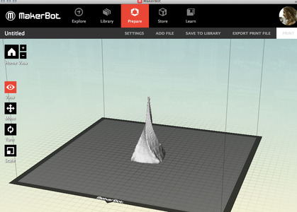

Step 4: Your First Scan!
Place your object in the middle of the build platform.
Start a New Scan on the digitizer software.
Choose the shade of your object.
Move out of view and press START SCAN.
The platform will slowly rotate and you will be able to see the lasers passing over the object.
As the object is scanned you will be able to see the object taking shape on your screen.
When the scan is complete you can decide to:
-Do a multiscan
-save the file to your computer
-share the file on Thingiverse
-print now!
Step 5: Do a Multiscan!
A multiscan will scan your object from a different angle and combine two scans into one object. The more info the better the scan.
Step 6: Share/Print/Save
When the scan is complete you can take a photo of the object. If you don't want it to be red (like my image) you can slide the filter to the side and reveal the camera.
This scan and photo can be uploaded to Thingiverse for personal or public use.
You can also choose the Print Now option and it will open the file in MakerDesktop Print software.
Last but not least you can simply save the file to your computer and open it in MakerDesktop another time.
