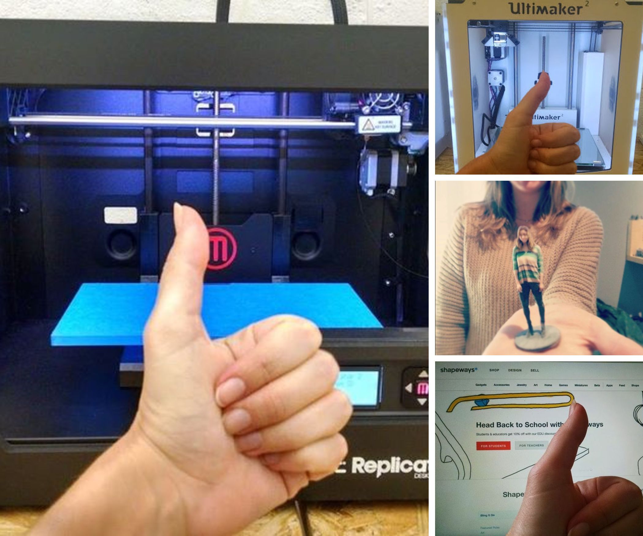

Introduction: Quick Start Guide: Printing With a Makerbot Rep 2
This tutorial will get you up and running with your Makerbot Replicator 2.
You will need:
-a 3d model in an STL format
-Makerbot Replicator 2 (or similar)
-SD card or cable adaptor for the Makerbot
