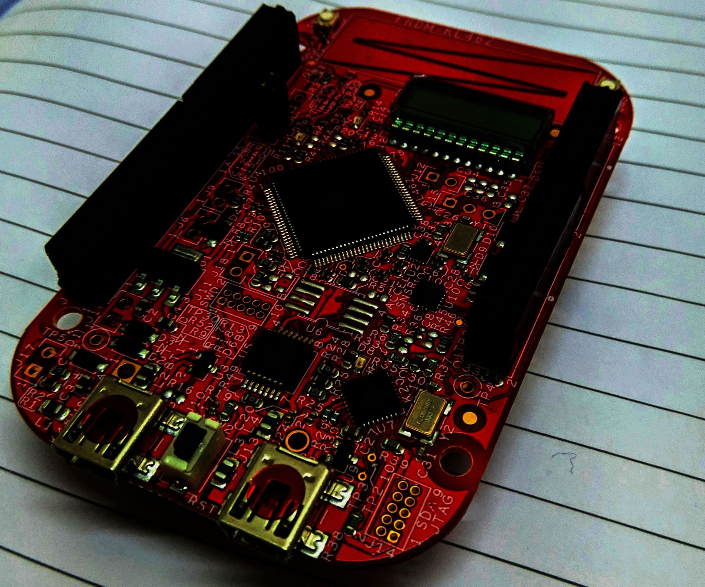

Introduction: Quick Start to STM Nucleo on Arduino IDE
Nucleo boards are the highly affordable and powerful boards from the ST Microelectronics. STM32 Nucleo boards allow anyone to try out new ideas and to quickly create prototypes with any STM32 MCU.
However, Arduino is unbeatable in this segment due its simplicity and ease of its IDE. The performance to the cost ration of the Arduino boards is very low, which make some hobbyists to look into other boards. STM has bought up the Nucleo development boards, whose performance to the cost ratio is pretty high as compared to that of Arduino.
Thanks to "STM32 Core" (Official) team for porting some of their popular Nucleo boards into Arduino IDE and helping all the Arduino users happy to the core.

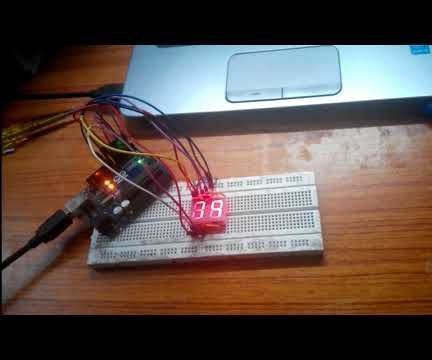

//Program to blink the onboard LED
#include <f401reMap.h>
int a = pinMap(12); //pinMap(Mapped Pin) - for mapped pin refer the attacted image int b = pinMap(1); void setup() { pinMode(a, OUTPUT); pinMode(b, OUTPUT); }
void loop() { digitalWrite(a, HIGH); digitalWrite(b, HIGH); delay(500); digitalWrite(a, LOW); digitalWrite(b, LOW); delay(500); }
