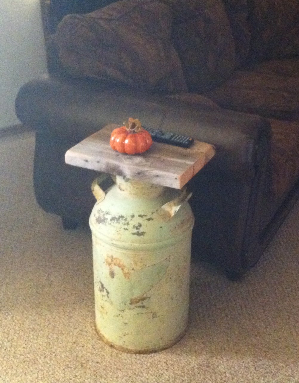

I got tired of balancing my beverage on the arm of the couch, an accident waiting to happen. I needed an end table, my style is old, rustic and primative. I couldn't find any out that I liked so I decided to build my own.

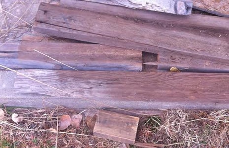

(3) 2”x4” x15” salvaged lumber Free scrap pile
(1) 2”x4” x6” salvaged lumber Free scrap pile

1. Measure and cut your salvaged 2”x4” wood into 4 pieces, three 15” and one the exact size of the neck of your milk jug. My neck was slightly less than 6”. You want it to fit snugly in the neck of the jug. I started at 6” and nibbled it down until it fit exactly.

4. Now, on a flat surface lay your three 15” boards face down. I chose the roughest parts of the boards to be the top, I wanted it really rustic. I love the funky knot hole.

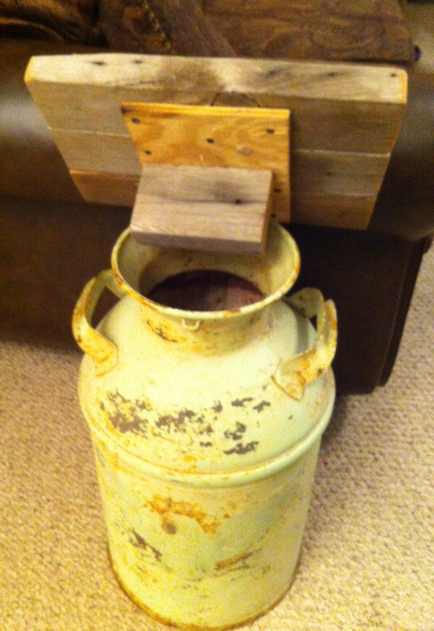

5. With your "top" face down apply glue to the 6”x8” plywood base and center it on the table top. You could use a clamp at this point to hold the boards in position, but I just had someone hold them for me.
6. Take the remaining screws and from the underside screw through the plywood into the table top. At least 2 for each board.
Step 3: Putting It Together
8. I then used the 80 grit sand paper to “smooth over” the sharp edges left by the table saw and add a worn rustic look to the top.
Step 4: Finished!
Depending on the age and condition of your Milk Jug you may want to either seal the “patina”(rust) with a can of spray lacquer or sand and paint it.
