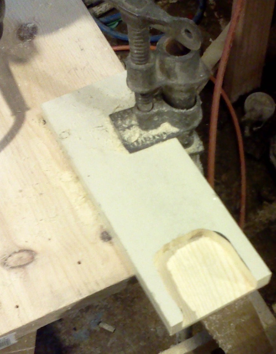

Step 2: Trace and Clamp
Trace your phone and clamp it to you work space
Step 3: Use a Router and Make the Cut
Straight bit, cut as deep as the phones thickness, had to change clamps in the middle the quick clamp kept allowing the board to move.
Alternatively you could cut and use 2 thin strips of wood and sandwich them between the two larger pieces instead of using a router.
