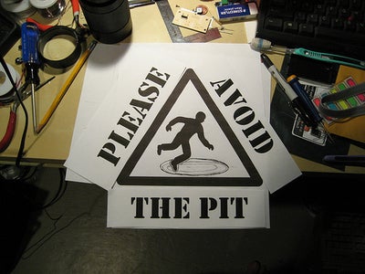

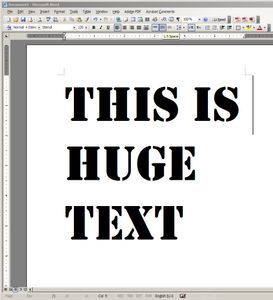

For this mask I decided how large I wanted the center image to be, printed it out, and then used that to decide how large the text would end up. I ended up making the text fairly large, as anything below an inch high is pretty time consuming to cut and hard to see.
As part of the quick and dirty, I did all the layout in the flesh, and just used the computer to get images and print text. My hand lettering is terrible, so I used a stencil font to match the industrial look of the sign.

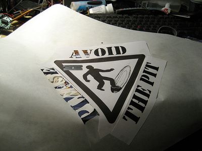

Once you have all the elements printed out, arrange them in their final positions on a sheet of freezer paper, with the shiny side down. This is how the final mask will look, so make sure you have everything where you want it. Tape everything in place, then start cutting! Single edge razor blades are my preference, because nothing is worse than a dull blade, and single edge razors are super cheap.
The advantage in laying everything out this way, for me at least, is that it saves having to build the image in Photoshop, printing the image out as several pages, then trimming the edges carefully and aligning all the joins. I just rough everything together on the freezer paper and it's ready to cut.

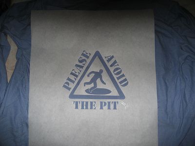

Iron out the shirt. If you don't have an ironing board some towels and a piece of plywood works fine. Next, position the freezer paper so that the mask is where you want it to finally end up. As you can see above, my mask is up in the middle of the shirt - make sure you position any islands also.
Start ironing the freezer paper down on medium to high with no steam. Working out from the center will reduce the number of wrinkles. and help you avoid missing areas. The entire sheet does not have to be ironed down, but get the edges and area around the mask stuck well, or your lines will be messy.
Once you've ironed on the mask, take it outside and shake up your paint. Slip a sheet of cardboard inside the shirt to keep the paint from bleeding through, then start painting. Light coats are best, if you lay it on too thick the paint will wick under the mask and ruin your day. (Note that spray paint does have a habit of getting everywhere, use newsprint to make sure anything you don't want paint on is covered.)

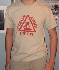

Once the paint is dry to the touch, peel the freezer paper off and you're ready to go! The freezer paper is one time use only, so just rip it off. You can wear the shirt as soon as you want, but let it cure for a few days before you try washing it. I've machine washed my shirt for the last 4+ years, and it's held up surprisingly well. Your mileage may vary depending on your fabric, but for cotton, machine washing is just fine.
