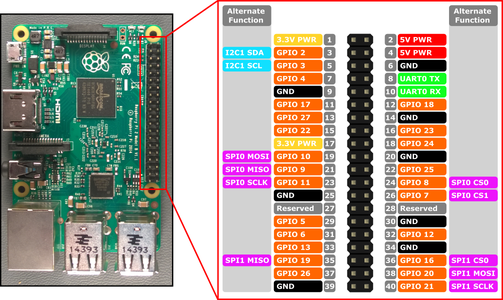

So the sensors have three wires. Red Black and Yellow, your might be different, but in my case the black is ground, the red is voltage and the yellow is data. You will need to put a 4.7k resistor between the data and the voltage wires before it goes to the Pi as seen in the photo above.
The Ground (black in my case) goes to any gound, I used pin 6. The Data (Yellow in my case) goes to GPIO 4 or pin 7. The Voltage (the red one on mine) goes to any 5v source I used pin 4.
Once everything is connected the software will automatically detect the sensor and add it to your dashboard on cayenne (see I told you it was easy).

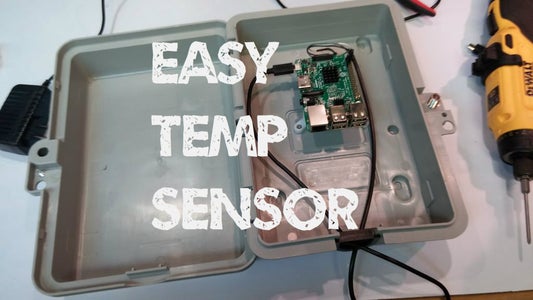

Step 6: Assemble
Once the sensor and the software are all set up, all that is left is putting it into a case. I used the pcb feet listed in the parts step and it worked great. I also connected a micro usb extension so that I did not have to open the case in order to plug the pi in.
Now that it is all set up I can move this sensor anywhere in the world as long as it can access the internet through wired or wireless internet, I can monitor the temperature.
