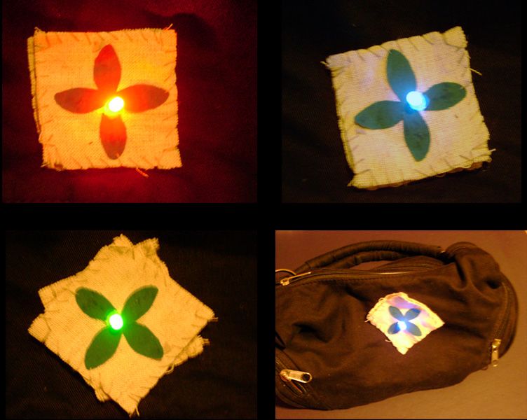

Last step is just put all the pieces together.
Place the foam piece on between the two taped fabric pieces (like a sandwich)
and saw them together, or just staple the edges as long as you not touching the aluminum tape.
The switch is ready!
