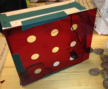

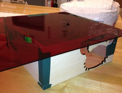

The first step is to construct a bottomless box out of whatever you have laying around.  You'll want the material used for the top piece to be rigid enough to support the work pieces pressed against it, but it also needs to be laser-safe as you are going to cut it in the next step.
Here I used some scrap MDF-core plywood and a scrap piece of 1/8" acrylic in a sweet shiny translucent red.  The translucent plastic helps you see the position of your work pieces underneath.
The one constraint here is that your laser system will need to have enough clearance for this box to sit on the bed, so size it accordingly.

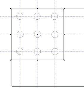

Step 2: Cut the Jig
Next, we put our constructed box into the laser cutter and focus on the top piece.  I designed a nine-hole jig for the river rocks that is slightly larger than the image we will be engraving.  Run the job to cut the pattern into the top of your box.
It is *very important* that you push the wooden frame of your box squarely against the upper left corner of the laser bed, or else registration will be off when you load up the box and attempt to engrave your objects.  I also marked the laser bed with blue tape where the edges should meet, and slightly oversized my aperatures for the etching.

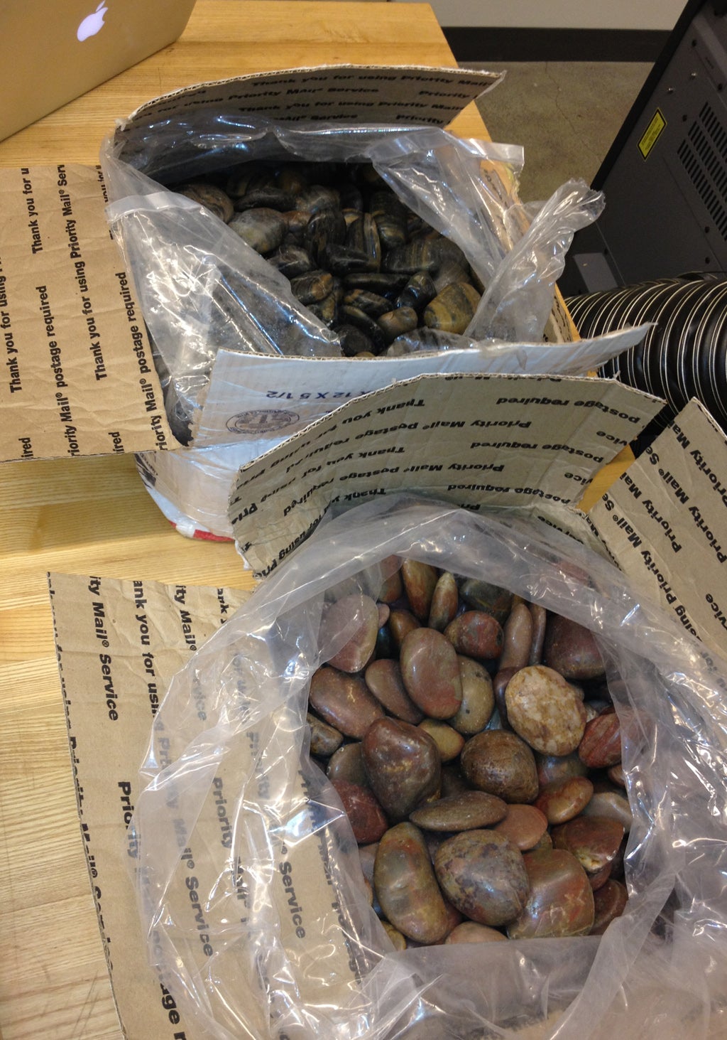

Step 3: Gather Your Materials. and a Little Bit of Info About River Rocks.
Ok, now that you have a jig that hopefully fits your material, it's time to load it up.  We are going to be etching polished river rocks which could be (and actually is the subject of) it's own Instructable.
A slight aside:  a few quick things about these kinds of rocks and laser etching.
  • You aren't going to get a deep etch of any great quality.  You *can* get a really nice quality light etch.
  • Basically you will be blasting the tumbled polished surface away, so your design will etch as white regardless of the color of the rock.
  • I was using power settings of 60% power, 70% speed at 300DPI for these rocks on a 120W Epilog.  Too much power and you will actually blast bits of granite off the surface and make a really nasty etch (and a big mess).  It's similar to the crystallization that occurs when you etch glass at too high a temperature.  If you want  a slightly deeper cut, two passes at lower power is the way to go.
  • For the 'contemplation stone' type tchochkies, a very soft sandstone is usually used which is then sandblasted through a mask that is laser cut.  That makes for a nice deep cut which can then be filled with enamel.  You can find instructions and materials for this online with a quick web search.
The makeup of these stones varies wildly, and if you are trying this you will undoubtedly get some weird ones in there.  Exactly ONE of these rocks engraved with a black finish instead of white.  Some would barely leave a perceptible mark at all.  On the upside, they are extremely cheap as opposed to the 'laserable stones' that you buy online for dollars a piece.

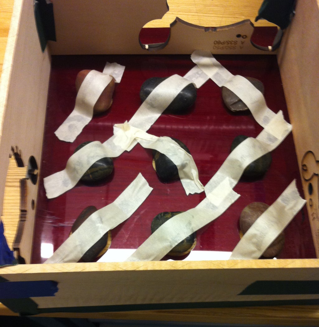

Load your material into the inside of the box with a decently flat face towards the acrylic.  With a nicer jig you may not need all the masking tape to hold them temporarily in place, but the rocks were heavy and liked to slip around before I secured them.
You may also need additional support if any of your material is undersized relative to the aperture in the acrylic.  Ideally all the material would be larger than the hole, as you are about to apply back-pressure to hold it all in place.

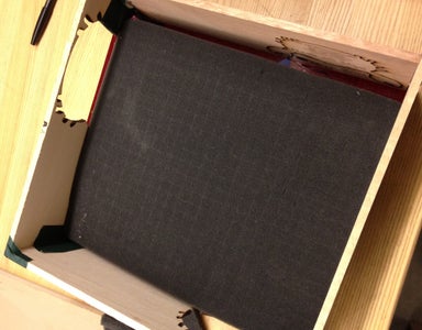

Next you insert a piece of thick foam-  this 2-inch piece came from a pelican case.  A piece of thick, dense eggshell-type foam would also work.
The foam needs to be stiff enough to be supportive of the work pieces, but also squishy enough to press around the contours of the work material.

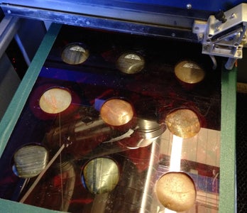

Step 7: Place the Jig in the Laser System, Focus, Register to Upper Left Corner, and Etch
Now you flip the jig over and check that all of your materials are in the correct place.  Depending on the fineness of your artwork, some amount of depth variation is OK.  The de-focusing caused by a non-flat surface will just make a blurry image.
Now focus the laser to the height of your material inside the aperture (which roughly the same height as the bottom face of the acrylic) and push the box squarely into the upper left corner to recreate the same registration as when you cut the jig.
Etch away!
