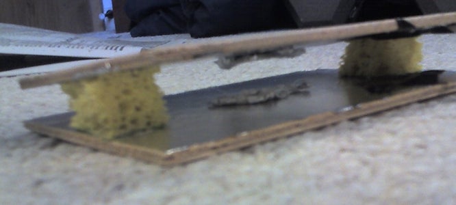

Step 2: Assemble Each Plate
*Glue the aluminum foil onto each plate, with a small balled up piece in the middle of each. (The plates can't get close enough together to actually touch)
  • Cut and glue two small squares of sponge on one of them.
  • Tape a wire onto each plate.
Step 3: Attach the Two Plates/Testing
Now, simply glue the plates together, via the sponges. (Aluminum foil on the inside) You're ready to test it out!
Testing:
Attach one pole of the battery directly to what you're testing on, for the other pole, attach one wire of the pressure plate to the battery, and the other to what you're testing on. Push down on the plate and hope it works!
If it doesn't
Check your connections, do both wires actually touch the contacts of the battery? Do both wires actually touch the contacts on your test subject? Are both wires touching the aluminum foil? Do the foil balls touch each other when the plates are compressed?
If it doesn't stop working
Check and make sure that the aluminum foil balls are constantly touching each other, that's most likely. If that doesn't work, add just a little bit of water onto the sponge, squeeze the sponges to work it in...that should make it a little bit springier.
