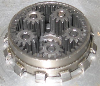

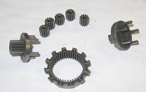

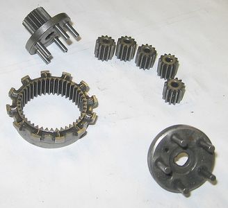

The parts you see in the picture where harvested from a Bosch cordless hammer drill ( sorry dont have the model number ) I think it has to be a hammer drill as the standard drills use plastic ring gears and planet gears I very much doubt if they would stand up to this abuse.
All these parts (amongst others) are used to reduce the speed and increase the torque of the dc motor used in the drill, we however are going to use them to increase the speed of our motor which as I said above will decrease the available torque.

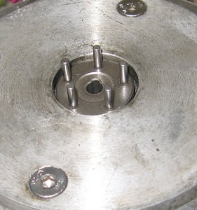

Take the chuck driver and remove the tangs on the back (not the planet gear pins you can remove these by knocking them out with a punch but keep them safe you will need them) which are used to drive the chuck in the drill simply grind them down with a angle grinder but dont go mad you want to keep it flat at the back. With the benefit of hindsight I now realise you could make use of these tangs by opening out your boss to accept them, they may even help with keeping it all square.
Once you have removed the tangs you need to attach this part to your boss, if you can find a shaft the same size as your motors shaft with a tapped hole in the centre then this is ideal you can secure the Chuck driver in place with a countersunk bolt this will help you attach it dead centre on your boss. otherwise your just going to have to be really careful and do it on the motors shaft.
Brazing would be a good solution here but I dont have access to any brazing gear so welded mine in place.
As you can see by the picture my pins are discoloured this is due to heat and will have destroyed the hardness of these pins so I suggest you remove them before working on this part then replace them once you are ready. All is not lost though I can still remove them and replace them with the pins from the secondary sun gear as they will not be needed, just a little harder to get them out this way.

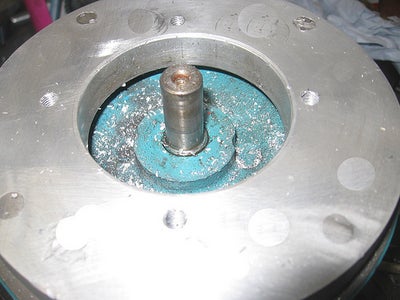

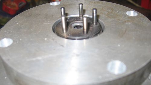

Put your boss onto the motor shaft and pinch the grub screw up, make sure the boss is securly seated before you do this as it is important that the boss cannot move further down the shaft but you cant put a retaining bolt in the centre as it will interfere with the planet gears and stop you putting a shaft into the boss gear.
You now need to measurement from the top of the boss assembly to the motor seating ring because you need to make the first bit of the housing to fit this measurement quite precisely. You will notice that mine is in two bits this was more due to making it up as i went along rather than any design. I suggest it would be better made in one part.

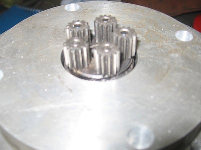

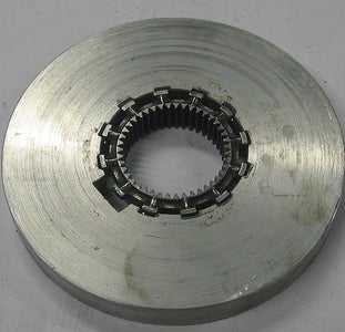

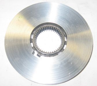

In these picture you can see the planet gears placed on the pins and the ring gear put over them, make a bit to fit the ring and file or machine the slots to accept the ring gear ( as you may notice I didnt make it from scratch I found a bit of aluminium with a hole already in it, the hole is a little large but i thought I can pack the gap with grease and it would seep through slowly as the ring heats up, maybe )
This needs to be a fraction smaller than the thickness of the ring gear so the top plate once tightened will clamp it in its proper place.
