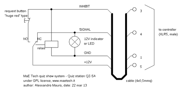

Take a look at the schematics.
The relays are decentralized as they are part of the pushbutton/lamp system circuit. In this way the circuit is more logical and easy to build. The buttons are Normally Closed, so they keep the relay excited closing its circuit. When the button is pressed the relay is released so two things happen: the button-relay circuit is opened, so if the button is released nothing happens (this ensures precise survey of the push instant), and the other circuit is closed turning on the luminous indicator, the acoustic indicator, and forcing the others relays on. The last matter is achieved through a network of diodes. Of course, the more stations you want, the more complicated is the network. Last but not least, reset and inhibit switches (logically different, electrically the same) will force all the relays on, closing again their circuits until a big red button is pressed.

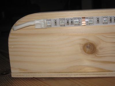

Step 2: Quiz Station Assembly

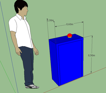

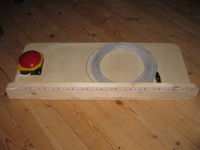

Firstly you have to build your own basement. I have opted for a very simple one, made with a wood board and a small piece of vertical panel for the led strip. Another possibility is illustrated (with google sketchup) in the image 4.
In my case I've cut a piece of plywood panel for the basement, and a piece of wood board for the vertical part. I've rounded the angles firstly with saw then with sand paper. I've assembled the two parts with vinylic glue and some screw.
If you want you can paint the basement with water-based paint.
In my case I've let the wood "natural".
Then you have to mount the base of the pushbutton with two screws and the LED strip with its adhesive plus some drop of cyanoacrilate glue.
If your basement is some kind of a box, all the wires may be passed inside, so they are not visible. In my case I was obliged to pass them on the surface making them visible. Note the small hole for passing the cable of the led strip. Also, there's a white hose hiding the wires of the led strip.

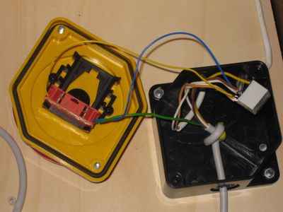

Finally make the connections with the relays (look at the schematics). The most important thing is finding the wiring diagram for the relay you are using. I'm using a GRUNER X1U-G320, and the spule contacts are the middle ones, the two apart are common (toghether). The other two are NC and NA contacts, and a tester is useful to find which is which.
At the other end of the 4-wires cable, solder a connector. I've used 5-pole XLR.

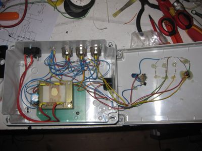

Step 3: The Controller

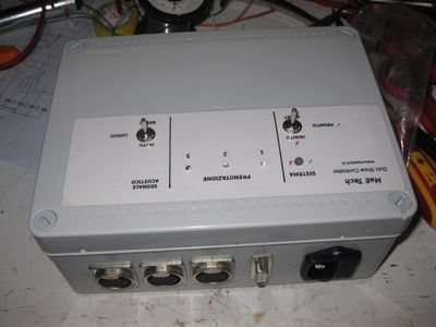

The controller is enclosed in a plastic box.
On the back there must be the 3 connectors for the 3 stations (i've used 5-pin XLRs), the mains connector (or the cable directly exiting, or a connector for external power supply if you prefer), and the "option" connector (optional).
On the top there must be one switch and one button for enable/disable and reset. I have used a combined rocker button which has three positions, center open, stable switch in one way and momentary button in the other way. There should be the switch for the acoustic alarm (optional, i've used three positions rocker switch), and there should be some indicator led: one for the system and 3 for the 3 stations. I have used bi-colour with two wire for the system.
Ok so make the holes, an additional hole is in the side of the box, for the buzzer. I have no main power switch as the device is intended to be detached from mains when not in use. If you use external power supply it is safer.
Mount all the leds, switches, connectors and the buzzer. For the leds and buzzer, hot glue will be very useful.

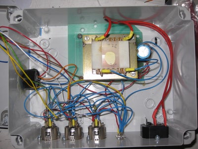

Follow the schematics and photos, all the resistors should be soldered behind the led's and switches. The few components for the buzzer timer can be soldered as a "dead bug", or you can use a small piece of breadboard if you prefer.
The 12 diodes should be soldered like a matrix on the back of the connectors. This is the probably most annoying phase of the build process.
Finally write the functions of the buttons and leds on the front panel, or printout a mask on adhesive paper as i have done.
