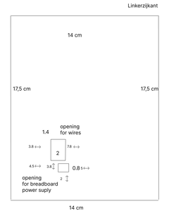

Step 1: Measure First
  1. Use a ruler or calliper to measure the exact dimensions of each component.
  2. Don’t forget to factor in space for wires, especially GPIO connectors and USB cables.
Step 2: Mark the Spots
  1. Use a pencil to draw the locations of each hole on the box lightly.
  2. Ensure logical placement: e.g. screen on front, GPIO access, screws.
Step 3: Drill Starter Holes
  1. Use a wood drill to create the base holes at the marked positions.
Step 4: Shape With Wood Rasp
  1. Use the wood rasp to carefully enlarge and shape the holes to match your components.
  2. Aim for a snug fit, but leave enough room for wiring, especially for GPIO pins and connectors.
Step 5: Attach a Metal Plate With Silicone Adhesive
  1. Attach the metal backplate to the back of the front pannel of the box of where you're planning on putting your HDMI screen using silicone adhesive.
Step 6: Test Fit Components
  1. Insert each component temporarily to ensure fit.
  2. Make adjustments as needed before moving on.
