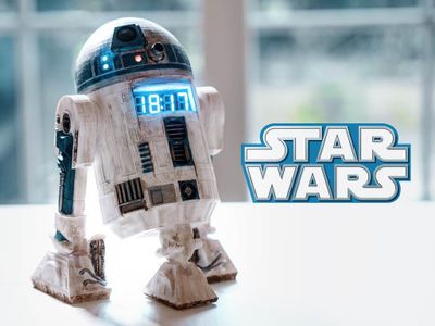

I wanted to make a R2D2 clock & timer cause I didn't have a timer in my kitchen (for my pasta) and I wanted an original timer, so I said to myself : R2D2 !!
It displays the time wich is connected to wifi.
Behind you'll find a rotary button to set the timer.
Push the button to set the timer, hold it 3 seconds to interrupt a countdown.
SIMPLE AND EFFICIENT !

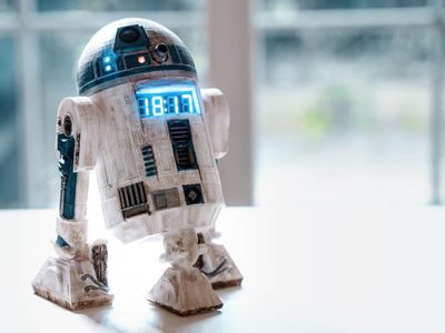

Step 21: You Made It !
