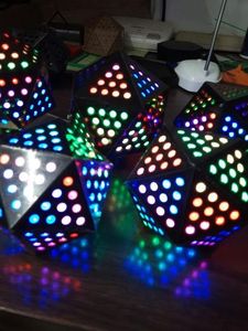

Hi again, have you seen the MANY cubes presented on the internet? Wow they all have great displays, expensive electronics and complicated codes. So I made a super simple D20 Icosahedron cube.
It uses atmga8 (1/2 the pram of a 328) but any atmga 328 uno will work. It has a 3d folding case that you place 200 led into and solder. It is self contained with micro, battery, and charger. A detailed code the you can change the flashing to what ever you like. It has 2 flavors, desk stand or hand held. It turns on by a piezo sensor tap, then flashes, then goes to sleep. This works about 46 cycles before the battery is low. Then when taped a red flash comes on indicating the battery needs charging.
This should take about 4-6 hours to make not counting the 3d print time. Many of the components you probably already have.

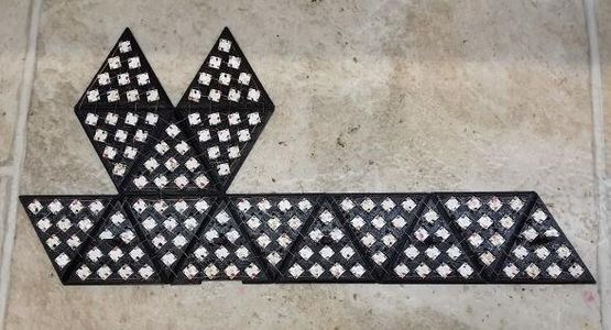

Step 3: WORK ON THE PENTAGON FIRST
You would think that pcbs would make this easy. If it was out sourced it may. I first tried with pcbs and cutting to just the right size, placing the leds perfectly, trying to get a soldering iron between the tight spaced leds, and then forming the ball took hours of time. Not to mention making 20 perfect pcbs. Then you have to paint. Wipe off the paint. This and the time to make the pcbs took more than 30 hours for one cube.
So I tried 3d prints. This made the leds easy to place but the leds do NOT have a marking on the bottom, like other leds do. So if I placed one out of order and wired it wrong the whole cube won't work. That is why I MARK the leds first.
I know this looks impossible but think of wiring just one triangle first. The plastic helps hold the wires in place so bare wire makes it easy. You will combine 5 triangles tying the inputs as one. This will give you 4 rows of 5 triangles.
I have a foldable 3d print of the top and bottom. Wire the leds as shown. My 3d prints changed to a diagonal to get the wiring easy. Start with the pentagon print for practice. Rotate it at each triangle to place and solder. I use plumbers flux and brush the metal tips of the leds. Then solder a pre tin blob on each leg. Then use bare copper wire to connect. The wire inside any lamp cord is good. I run the strands through fine sandpaper to get shinny so they solder easily. Wire as shown. Then jump with coated wire to connect the vccs, the grounds, and the inputs.
When finished wiring the pentagon you should test before folding. Now is the time to fix any leds that don't work. When folding the cube into shape the wires want to touch and bend inward into the fold (not good).

Step 4: BOTTOM HALF
If you got the pentagon to work then move on to the bottom print. This works the same as the pentagon only 3 times more leds. The center of the pentagon is the input for the pwm nixi driver.
The triangle is the same all 20. The cube bundles them into 4 rows of 5 ea. The top is 5 triangles tied together, mid triangles, mid-bottom triangles, bottom triangle make up the 4 rows. You can see the pentagons easily but the long flat array of 10 is harder to picture. The triangles pointing down are the mid. The triangles pointing up are the mid-bottom. the attached pentagon is the top. The removed pentagon is the bottom. You fold the big structure to make a ball. The opening in the bottom allows for placement of the electronics. then you can wire the bottom to the ball. I let the cube play for a few days before I glue it shut.

You can see my pcb made cubes. They look drab next to the 3d layouts. Leds NEVER photograph well. I tried 4 phone cameras and they still don't show good colors. To hold one of these in your hand is really cool.
THANKS FOR VIEWING....but you really need to make this.
