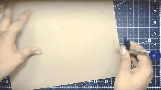

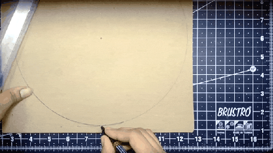

Step 2: CUTTING CARDBOARD

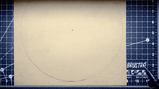

  • Make a Hexagon, here I used a technique for quick making of hexagon accurately using a circle.
Circle Diameter = 24cm

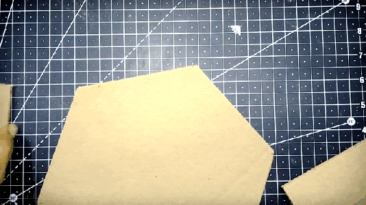

  • Cut the sides according to the measurements given in step 1

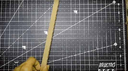

  • there are six sides in an hexagon, so cut six cardboard pieces for sides according to measurements given in step1
Each Side Length = 12cm
Height = 10cm
12cmx10cm
STRIPS = 1.5cm

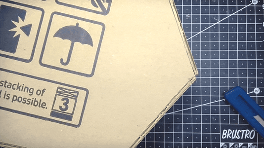

  • Use sharp knife while cutting, for accurate edges and smooth cutting.
  • Safety precautions must be taken while cutting.

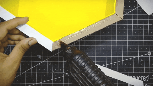

Step 3: ATTACHING & FIXING

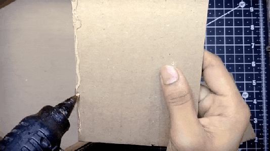

  • Start attaching the side pieces of cardboard using hot melt glue or any instant glue.
  • Here I used a technique to strongly and neatly attaching sides pictured above.
  • Every side should be stand straight and should stand at same height.
  • Here I used a technique, that how to apply glue smoothly pictured above.
  • The glue should cover every edge, so the shelf tend to be strong and covered.
  • Make it for all next 6 colors

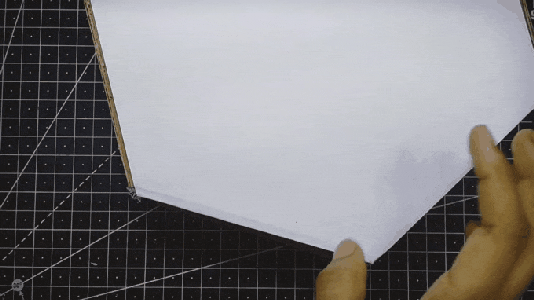

Step 5: COLORING OUTSIDE SHELF
  • Use A4 sheets instead of using some costly papers.
  • Use only thick paper (<80 GSM) for better look.
  • Use only pure white looks more attractive.
  • Simply follow the GIF and ask any doubt in comment box.
  • Do the same thing for remaining colors
