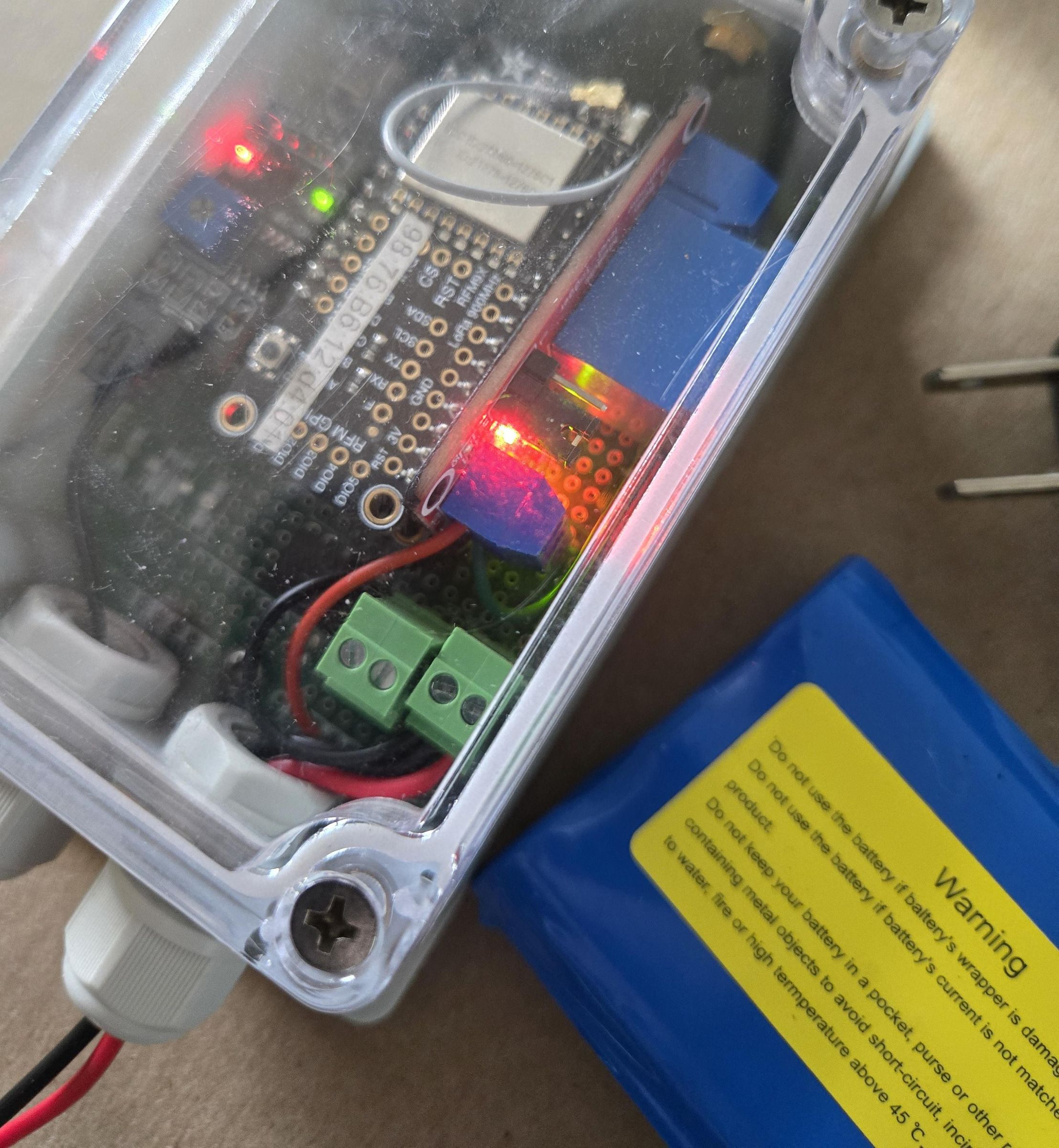

Step 4: Assemble the Hardware
I really recommend assembling and testing the WIS Block components first outside of the case...
  1. RAK baseboard (19007),
  2. RAK 4631 module in CPU SLOT,
  3. ATTACH A BLUETOOTH ANTENNA TO THE 4631,
  4. ATTACH A LORA ANTENNA TO THE 4631,
  5. RAK 12023/12035 (soil sensor) module in IO SLOT,
  6. RAK 12500 GNSS GPS module in SLOT A,
  7. leave the battery unplugged for now.
You can now connect your RAK to your computer and go to flasher.meshtastic.org/ on your computer's internet browser and flash the device with the most recent firmware. This is really just to test the device and pair with your phone app if you like. We will put put modified firmware on it in the next step.
Once flashed...
  1. Can you pair your phone with it using the app?
  2. Can you get into the configuration screen?
If so you can unplug the usb and set the assembled RAK device aside for a moment and grab your case. We don't want to shove things into the case immediately, we actually want to deconstruct the case as much as possible to begin the process. This is probably already the situation, but if you find that somehow things magically attached themselves to one another.. undo that. :)
  1. Drill a single 1/2 inch hole (or whatever size is appropriate for you to mount the latching button in your enclosure) and mount it,
  2. Make a power button 'harness' for your battery by basically placing the button inline on the positive lead, assemble battery/power button harness. and test it with the voltmeter.
  3. Disconnect the battery and install the button.
  4. (optional) Attach the usb-c type 90 degree adapter to the RAK.. This will make it WAY easier to connect the usb cable to it once it's mounted in the enclosure.
  5. I recommend you stop short of installing the device in the enclosure. It's just easier to work with and troubleshoot if you leave it out.

Step 10: Field Test & Enjoy
So now that you have soil sensor monitors.. You will want at least one Meshtastic device to act as a 'CLIENT'. This is the one you will carry around or have in your truck and have paired to your phone. It will be responsible for receiving environmental data from your sensors and giving that data to your phone app so you can see what is going on. It also just is your basic Meshtastic Radio device for sending and receiving messages from other Meshtastic users (both on your Channel and on the Public (pre configured Long-Fast) Channel.
Pair your Meshtastic Radio Device with your phone.. fire up one of your sensors.. do things. I suggest having a hose handy or at least a wet washcloth or paper towel. but you should be able to manipulate the state of the sensor and see it update in your phone app. Things are happening in real time, but they are not magically instant. Keep in mind your intervals you set on the sensor as well as allow time for data propagating from device to device when testing.
Step 11: Optional, But Highly Recommended.. Build Meshtastic Repeaters for Your Network!
If you are needing to cover any significant amount of distance it is wise to plan for it. While a pair of Meshtastic nodes can connect over an impressive distance, this is very much dependent on your transmission power (which is legally limited) and the antenna dbi rating (again legally limited) and positioning (the higher the better). A number of environmental factors go into the decision making around what antenna and where to mount it as well so it is worth a little research and consideration before selecting these items (antenna, cable (if needed), booster, mounting hardware). What I'm getting at here is you are not gonna want to pack around the type of antenna you really need to optimize range... we just want our carry radios to work.. get the data.
Easiest way to make sure we are in the coverage area is increase the coverage area by adding a few Repeater or Router type Meshtastic nodes. We can power these with solar, house them in waterproof cases, give them big boy antennas and position them as we choose. I added two and one later for my purposes but it was worth a little explanation at least. Here is an Instructable describing how to build a repeater node with a pretty creative solution for a case.
Good stuff, only notes..
  1. you can go up to a ten dbi antenna if you like, look into the broadcast profiles of the different antennas and even the directional options before selecting. Your environment is the biggest thing to consider here, but you will see how that applies as you understand the broadcast profiles of the different options.
  2. this could just as easily be configured as a Repeater if you had a reason, there are slight differences some resulting in more efficient power use.
  3. there are probably better options for cases (nicer than the one I cobbled together from random parts I had laying around), but it is an all in one solution w/ appropriate solar panel. :)
