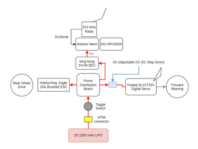

The RC car required more electronics integration. The servo was removed and replaced with a simple Futable digital servo. The LiPO that I chose to use was a 2S (7.4V) 2200mAh battery. Since the servo required max of 6V, I used a step down converter to safely power the servo
The block diagram above shows power system for the Arduino Nano with the BEC (5V/3A) used to power it and the serial telemetry radio.
