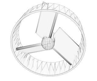

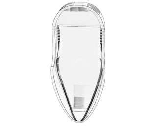

7) -Modelling of the parts- Using a 3D modeling software (123D Design), the next step is actually to design and print your RC boat hull, the servo extension and the propeller. Make sure that the boat is wide and high enough to place the Arduino and the breadboard in the boat.
8) Now, you need to use a drill to make a hole in the propeller. The hole needs to be about 2mm (diameter of the end of the DC motor)

Another problem was that the first boat we printed was not wide enough for the Arduino to enter the boat. We then printed another boat 3cm wider but the printer broke during the process. In order to present you a “boat” we used a Ziploc food plate to simulate a boat hull.
