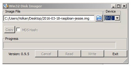

2. Printing Operating System to Micro-SD Card
We extract the downloaded image file from within the zip.Then we open the Win32DiskImager program we downloaded earlier. We choose our img file from the specified location.
Once you are sure your Sd card is connected to the computer, you can see it in the Devices section. Then click on the write button and start burning. The writing process takes about 5-7 minutes. The completion of the writing process is indicated by the newly opened window "Write Successfull." Wait until you see the article.

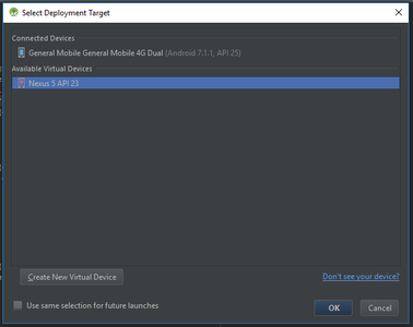

    • Using Android Studio This method assumes that you are an android developer.
      • Download android Studio from here!.
      • After downloading and making the necessary adjustments, you need to activate your phone's developer options;
        • Settings ==> About Your Phone ==> Compile Number 5 times in a row. The Phone will now say that you are a developer. In the same way
        • Settings ==> Developer Options ==> Turn on.
        • Settings ==> Developer Options ==> Enable USB debugging
    Now, after you make sure that your phone is connected to the computer and that the phone is recognized by the computer (install the drivers if the phone is not recognized by the computer), In the Android studio environment, you should check that your phone is recognized. The simplest control is to display your phone model on the screen that opens by pressing Shift + F10.
    Now, all we have to do is click on the Terminal tab on the bottom left or press Alt + F12. On the opened terminal screen;
    • adb shell
    • settings put global captive_portal_detection_enabled 0
    If everything goes well, you should type settings get global captive_portal_detection_enabled in this command and the terminal should also type 0 (zero). If you see 0 (zero), you can now connect and use the car smoothly

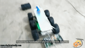

Vehicle Type 2: Tank Type Vehicle
  • There are 2 direction control motors, right and left engine. The operation is shaped like a tank.
  • As can be seen from the pictures below, the rotation speed difference between the right and left motors is used for right and left turns.
6 X 6 VEHICLE !!
LIST OF MATERIALS
Product Name Piece Raspberry Pi 1 Raspberry Pi Camera Module 1 Wi-Fi Adaptor 1 (Pi 3 için isteğe bağlı) L298N,BTS7960,L293 Motor Drive 1 or 2 DC MOTOR 2 or 4 SERVO MOTOR 2 12V Lipo Battery 1 Jumper Cable ~ Vehicle Chassis 1 5V Power Supply (LM2596-ADJ) or (2A Mini) 1
  • This vehicle used 6 (3/3) motors in total for moving back and forth / right and left and two motor drives for driving this motor.
    • The BTS7960 was preferred here as the engine driver. L298N / L293 etc. Motor drives can be used.
  • The difference in rotation speeds of the right and left side motors was used for steering movements.
  • Two servo motors were used for camera movements.
