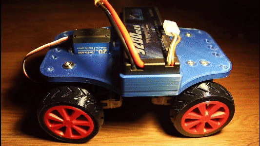

Step 7: Car Steering
Right now when one of the wheels turn, the other does not turn with it, well obviously because they are not connected in any way...! [Clip 1]
To connect them together for the car steering, we can simply use this beam that attaches to pivot points on both of the spacers of the front wheels. This simple connection means that now, as one of the wheels turn, the other turns by that exact amount. [Clip 2]
Step 8: Servo Motor Steering
To be able to control this steering, we can use a servo motor, with an arm connected to the middle of the beam like this. [Image 1]
So now, when the servo motor rotates, both wheels rotate in that direction, completing the steering and front wheels of the car! [Clip 1]

Step 10: Second Level
So far so good, but as we can see right now, there really isn't a lot of space to put anything else on the car easily, for example the electronics and boards. [Clip 1]
This is where the second level comes in, which is attaches to the main board using 4 spacers, which have insert nuts on both sides to easily bolt on the main board and the second level board. [Clip 2]
Now we have plenty of mounting holes and a place where we can put the on-board electronics. [Image 1]
