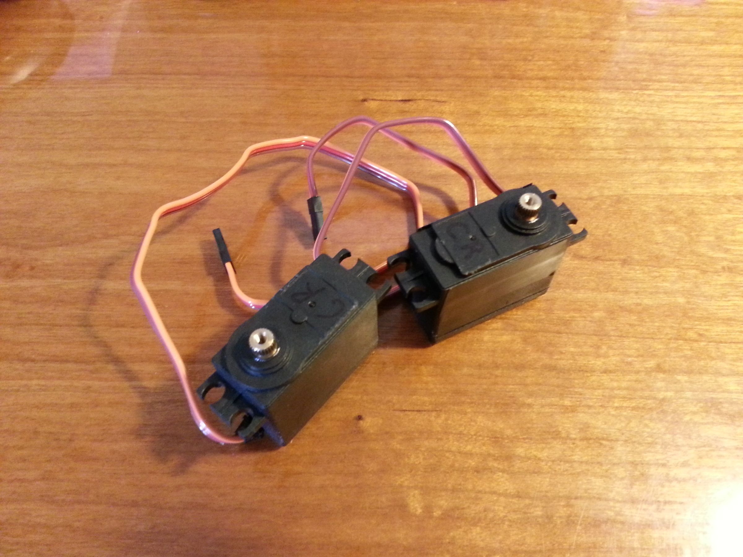

Servos
TowardPro(knockoff) MG996R Analog Servo, Futaba Compatable - Modded for continuous rotation

Step 9: Tank Steering W/Continuous Rotation Servos
This final step is a culmination of all previous topics and my tank steer code. I made the tank steer code to only use the right thumb stick of the transmitter to then control two CR servos. Remember that my TX is set to mode 3 and I don't have any channels reversed. The right thumbstick is channel 3 for the horizontal axis and channel 4 for the verticle axis. Following is my sketch using an Arduino UNO instead of the MEGA. I'm using differnt servo limits that enable a micro-servo to move a full 180 degrees and them different range for tank steering to give more sensitivity.
Make sure to thank my wonderful model Sid (above picture) for being such a good sport while I've been using him to refine my program.
