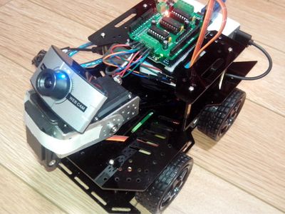

A wifi car based on Arduino
by suing openWRT
Aim: DIY a wireless car based on Arduino. By controlling the car, we can see the other things in the remote location, or can monitor the security.
Effect by picture:

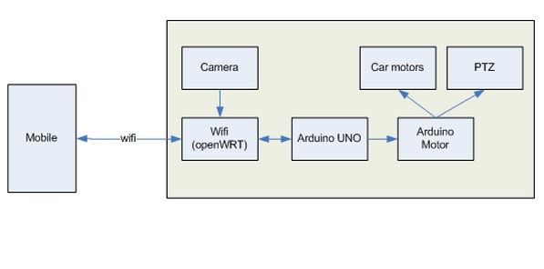

Principle:
l Brush openWRT into wireless router (like WR703N), and install mjpeg - the streamer and ser2net software.
l Mjpeg is used to deal with the video data from camera, and then send it via the Http protocol to the third party.
l The third party such as mobile phone through wifi access routers, send control instructions in the TCP connection
l After receiving instructions through ser2net, router would send instruction to the binding of a serial port, this is Arduino UNO.
l After receiving instructions, Arduino can control the expansion board (or shield), and then the shield would control motor, sensors, servos, and other electronic components. Finally, the motor and steering gear will execute instructions.

Step 1: The Overall Effect
Step 2: Principle of the Intelligent Car
