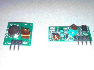

Are you looking to make your own quadcopter drone or RC car with Arduino but don't know where to start? Perhaps you already bought some 433MHz RF modules only to find out they weren't as simple to use as you thought? Try this out!
You'll learn to wire a simple proportional control transmitter and receiver with button trimmers and send the signal over a UDP-like setup. The code can handle as many channels as you'd like to use (in practice you'll probably use 4 channels for THROTTLE, YAW, PITCH, and RUDDER) but in this example I'll demonstrate a 1 channel setup and display the data on the Serial Window to give you the basic idea of how it works. This is intended as a learning tool to get you started into the world of wireless transmission.

Step 1: Wire Up the Circuit As Shown in the Image:
For your own learning:
  • the buttons are connected to pull-down resistors (pulled to ground), this guarantees that their digital readings will be 0V when the buttons aren't pressed instead of floating.
  • the potentiometer and the first 1kΩ resistor form a voltage divider. The 1kΩ is necessary to prevent a short from 5V to ground when the potentiometer reaches 0Ω.
***NOTE: all red cables are VCC (+5V) and black cables are GND, check carefully when wiring up your transmitter / receiver modules. Also for the receiver module, both DATA pins give the same signal so pick any.***
