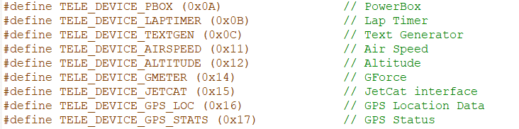

This was mostly done for me by Raymond Domingo. They had already made an altimeter compatible with Spektrum, so following that source code really helped. The Spektrum telemetry datasheet filled in the rest of the gaps. Measuring the data levels out of the receiver showed that I would need 3.3v logic.
The receiver sends the device address, and then expects a 16-byte reply. The datasheet shows the structures for all the various sensors. Even if the structure isn't 16 bytes long, the receiver expects 16 bytes back each time.

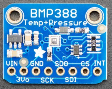

I used a BMP388 breakout board from Adafruit for pressure sensing. The breakout provides I2C and SPI breakouts, and works at 3.3v or 5v logic. Adafruit always does an amazing job with their breakout boards, so I purchased it. I used a DFRobot Gravity BMP388 board instead in my build since my Adafruit board was already in use.

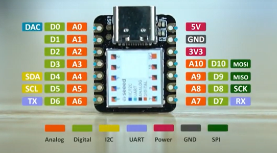

Given that the host I2C device uses 3.3v logic, I needed a 3.3v microcontroller, and I wanted it to be small. I was going to use a Adafruit Trinket M0, but they're relatively expensive, and don't have very many pins broken out. Then I found the Seeeduino XIAO board. It is a M0 board with both I2C and SPI ready to go, with a USB-C connector. Also, it's really tiny! Overall I really like this board (even though the slow startup crystal took me forever to figure out).

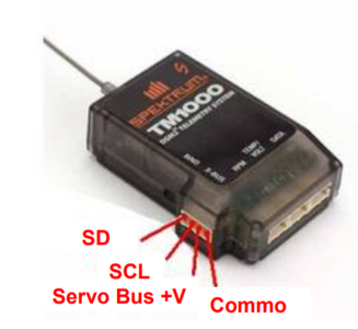

Spektrum uses a JST-XH size 4-pin male connector on the receiver for the "Xbus" port that we will be tapping into. I used a 4-pin JST-XH female plug on the altimeter and it worked perfectly.

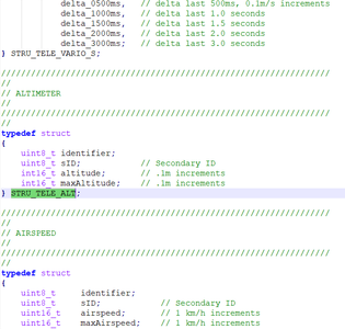

I used the Arduino IDE to write all of the code. I copied the Spektrum telemetry protocol out of their datasheet and added it to my Arduino library. Since Adafruit always has nice libraries for their breakouts, I used their BMP3XX library for the BMP388 sensor.
The main takeaways from my design are:
- Setup the I2C to behave as a client device and respond to the Spektrum altimeter address (0x12).

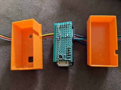

Step 4: Wire the Circuit
I used protoboard, but if you want to take the time to design a custom milled board, you could make the circuit a lot cleaner.
I connected the JST-XH connector to the XIAO's I2C pins. Since the receiver outputs 5 volts to the telemetry bus, the positive from the bus went to the XIAO's VCC pin. That way the onboard 3.3v regulator is used to power the BMP388 sensor.

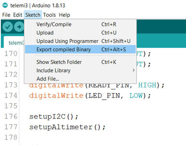

- Select "Export Compiled Binary"
- Once compiled, the .bin file will be in your Arduino project folder.

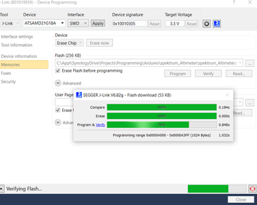

The Adafruit guide is very thorough, but these are the basic steps:
- Solder jumper wires to the back of the XIAO board.
- The Adafruit guide didn't say the RST pin on the 2x5 breakout board needed to be connected to the reset pin on the Adafruit boards. But for the XIAO, I needed to connect to all four pads on the back of the board.
- The VREF pin needs to be connected to the XIAO 3.3v pin. This tells the debugger that the device logic is 3.3v. Without it, if you select the wrong option, you could damage the microcontroller.
- Connect the jumper wires to the J-Link.
- Power on the XIAO board with a USB cable.

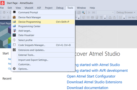

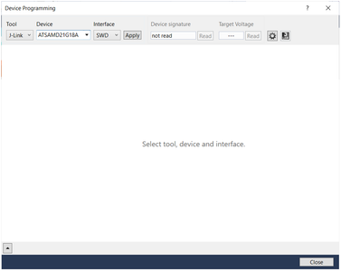

- Open Atmel Studio.

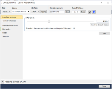

- Select Tools --> Device Programming
- Select your M0 board. In this case, the ATSAMD21G18A
- Select SWD.
- Read the configuration from the target.

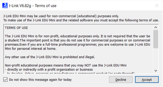

- If you're using the EDU J-Link, agree to the terms of use (if you're abiding by the terms of use).
- Verify that the read in voltage is correct in the upper right hand corner. If it isn't 3.3v, you could break your board!

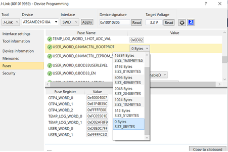

- Clear the boot protect fuse (set the bootloader size to 0 bytes), and then select program.
- In the memories section, select your compiled .bin or .hex file, and select program.

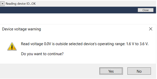

- When you read the device configuration, if you get a voltage out of range error, then make sure the MCU is plugged into power and that the J-Link VREF pin is connected to 3.3 volts.
