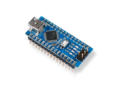

  • 1x Arduino Nano R3 (you can use any Arduino board).

First, I solder Arduino Nano R3 on Zero PCB board. And programming wires.
Then I solder the NRF module with wires to the Arduino Nano according to the circuit diagram and you will also need to connect 10uf 25v capacitor on the 3.3v and GND of the NRF module
Lastly, I connect INPUT and GND of Arduino Nano to the positive and negative of 7.4v Li-po battery
