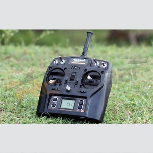

1. Transmitter with DSC Port
Please make sure that you DSC port happens to be a 3.5 mm stereo jack (female).
I'm using an Avionic RCB6i, a 6 channel TX, manufactured for RcBazaar
I bought mine from the retail store of Kinetic Hobbies, in Mangalore, India.
They sell all things required to build RC models.

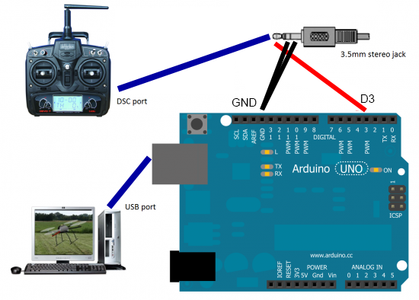

Step 5: Make the Connections
1. Plug in the pin headers to the Arduino
  • Black wire to GND
  • The other one to digital pin 3 (D3)
2. Plug in the jack to the DSC port
Your DSC port will most probably be on the front or the top of your Tx.
3. Connect the Arduino to PC
USB
4. Power ON the transmitter
If your connections are right, the transmitter will give you some sort of feedback.
For example, mine shows "PPM" on the display.
If your transmitter hasn't got one, it might beep or blink a LED.

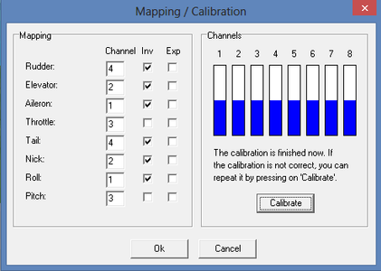

Step 6: Map and Calibrate Channels
Do as shown in the images.
In FMS, click Controls > Analog Controls
1. Select Serial PIC interface
This will select TX & Arduino as our input device.
2. Click Resources Set port and baud rate.
COM Port varies but baud rate is 19200, as set in Arduino.
3. Click Mapping/Calibration.
4. Map TX Channels
The channel settings for RCB6i are shown in the image.
Note: Keep mixing OFF.
If you have a different TX, consult its manual and change to the corresponding channels.
For example, the manual of RCB6i states
ch 1 - aileron
ch 2 - elevator
ch 3 - throttle
ch 4 - rudder
Tail, Nick, Roll and Pitch are the settings for copters.
They correspond to Rudder, Elevator, Aileron and Throttle in planes.
You might need to invert your channel and set exponential ON based on your transmitter's settings.
5. Calibrate Channels
Click calibrate and follow the instructions shown carefully.
