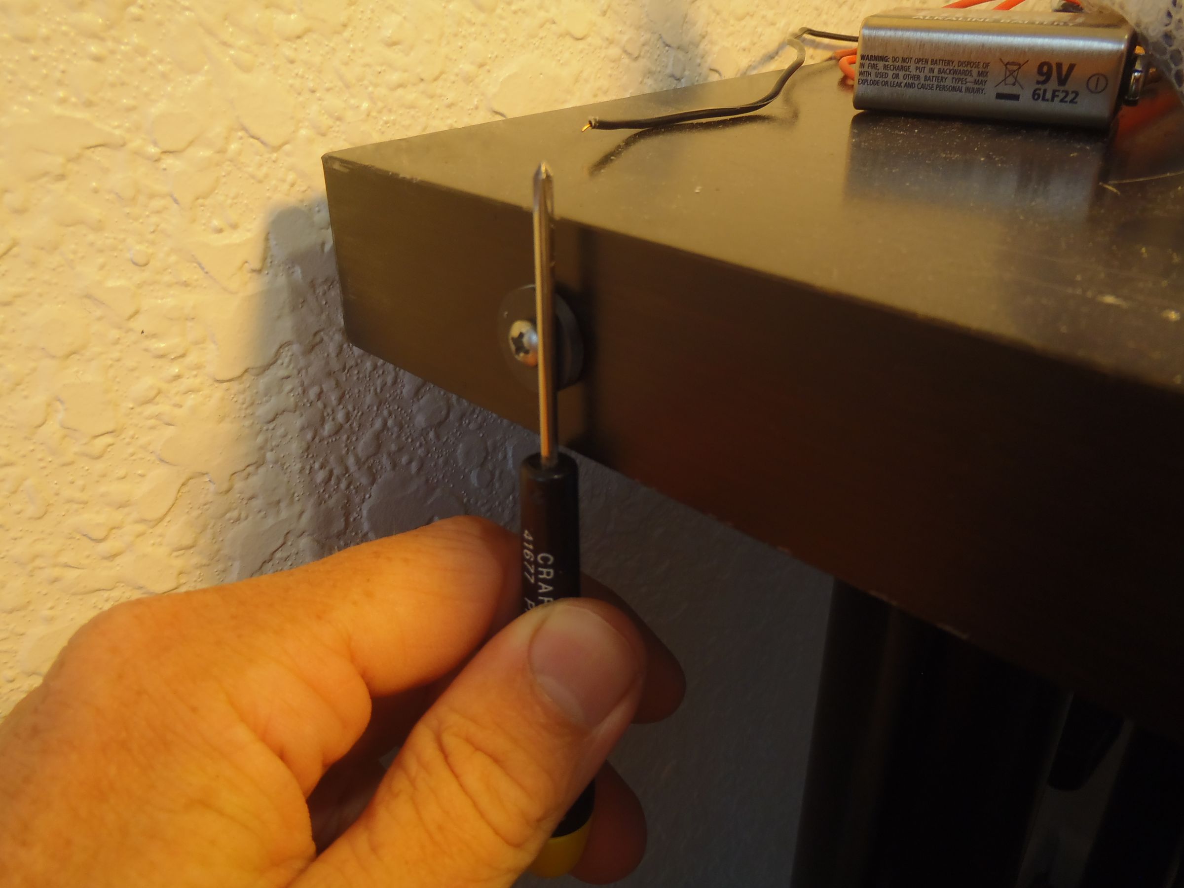

Step 3: Prep Your PINGs and Power
PINGs
- Attach 8" wires to all three pins of your PING sensors.
- Test your sensors using the PING example sketch in the Arduino IDE under File>Examples>06.Sensors>Ping.
- Label at least 2 of the three wires on each sensor with a piece of tape and a pen. Or use different color wires. I used all black wires for aesthetic purposes as I wanted them to blend into the frame as much as possible. This will be important later when we attach the sensors to the frame and will be unable to see if we accidentally crossed any.
- Using your Ammeter set to measure resistance, test the pins of the power plug. One pin is connected to the outside of the plug, and one to the inside. Adruino needs the center of the plug to be positive so it is important we know which pin is which. Once you have determined which pin connects to the center label it "+" with a marker.
- Extend the 9V battery leads by 6" and cover the connection with some heat shrink.
- Once the wires are cool from you previous soldering and heat shrinking, slide another piece of heat shrink down each one. Keep it well away from the ends.
- Solder the red battery lead wire onto the pin labeled positive on the plug, and the black led to the other pin.
- Slide the heat shrink back down the wires until it is against the power plug. Heat and shrink.
