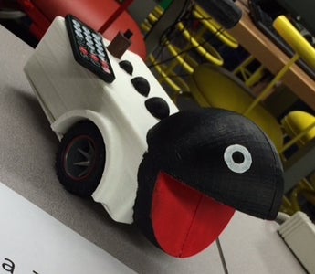

Introduction: RC Car (Theme: Chain Chomp)
This instructables was created in fulfillment of the project requirement of the Makecourse at the University of South Florida (www.makecourse.com)
This project is simple concept and an easy build. The RC car is fairly basic and code can be modified so the RC car can do more than just drive forwards for 2 seconds. Enjoy!

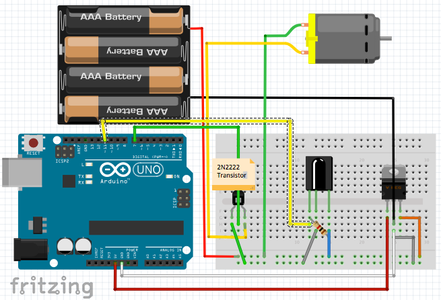

Circuit consist of:
4 AAA batteries
1 4.8 battery pack
1 6v DC motor (can get from cheap toy car)
1 Half Breadboard
1 Arduino UNO R3
1 22N2222 Transistor
1 IR Receiver
1 10K Ohm resistor
12 wires

Step 3: Put Circuit Together
Follow diagram to complete the circuit.
Photo was made using Fritzing app.
Note: DC motor that was used was a 6V motor that was taken from a cheap RC car. Picture of the motor being used is included in this step.
Step 4: Download STL Files
Download STL files.
File titled base.STL has to be printed in halves in order to avoid 3D printing extra supports. This photo is of the half that should be 3D printed first. Remember to mirror halves on the MAKERBOT software (if that is the 3D printer of choice) so parts can be assembled and glued correctly together.

Step 5: Attach DC Motor to "BottomBase" 3D Print
Use super glue to glue DC motor with wheels onto the Basebottom 3D print. There is a slot on the print that allows the motor to slip snug in like the photo shown.
Step 6: Place Electronics on BottomBase
Using double tape, the battery pack can be taped to the bottombase 3D print (as shown in the photo above).
Also, tape the breadboard on top of the battery pack so that all parts are not wriggling around inside the car when it is in motion.
Step 7: Add Rear Wheels to Reduce Friction
Using a plastic hanger and wheels from a small toy car (as shown above), double tape or super glue them to the bottom of the Bottombase 3D print (as shown in photo above) to allow car to drive better.
Step 8: Secure Arduino to Base 3D Print
Make sure to super glue the 2 halves of the base together.
Then, attach the Arduino to the inside of the base (as shown in the photo above).
Step 9: Complete Assembly
Plug the yellow wire from the breadboard to the 11 Pin and the green wire to the 7 Pin on the Arduino.
Refer to the Fritzing diagram to make sure the circuit is set up correctly.
Step 10: Fail Step Is Paint!
Apply paint and have fun!
Step 11: Turn the Battery on and Press Power!
Here is a video of the Project itself, working.
