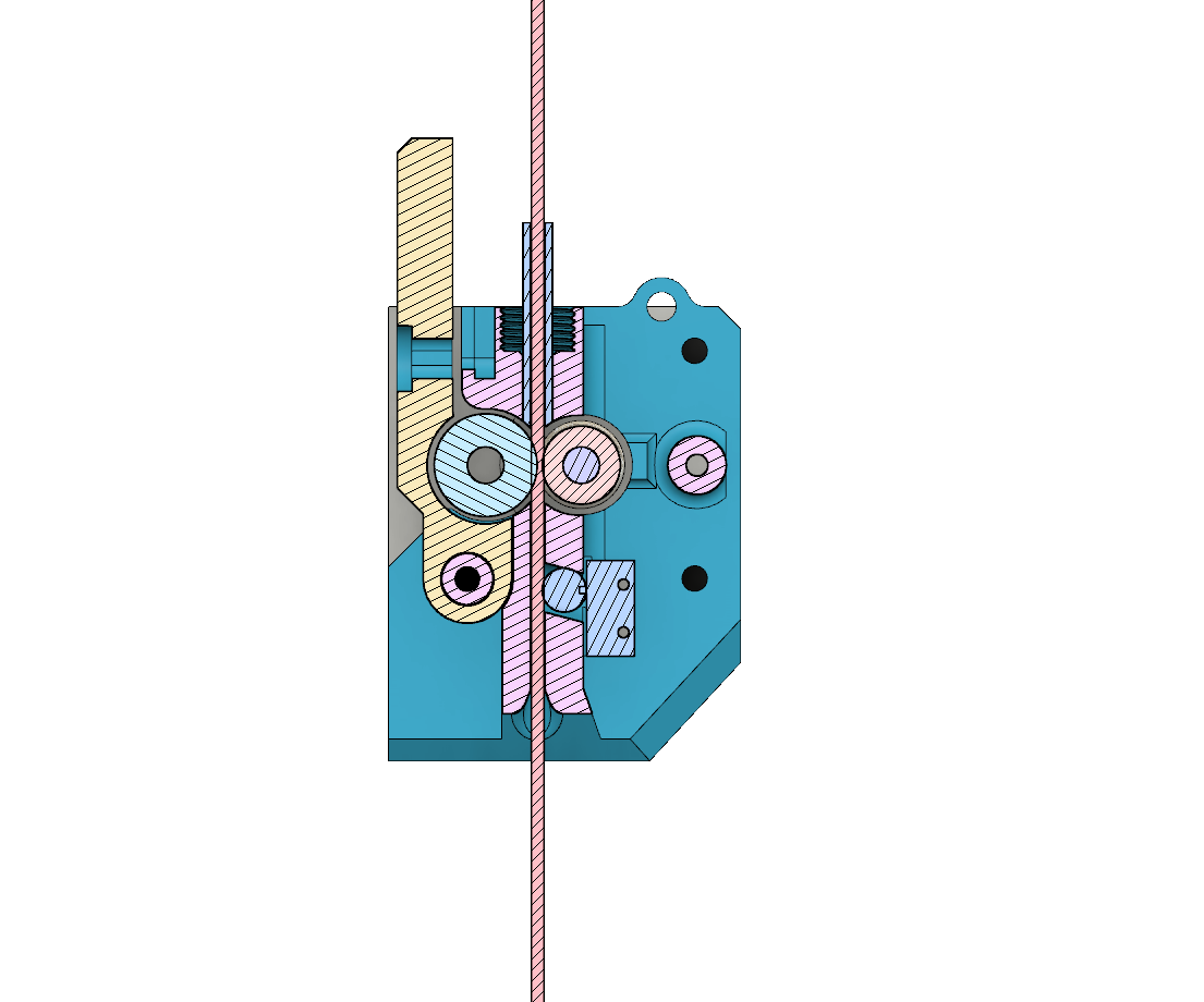

Step 2: Build the Extruder

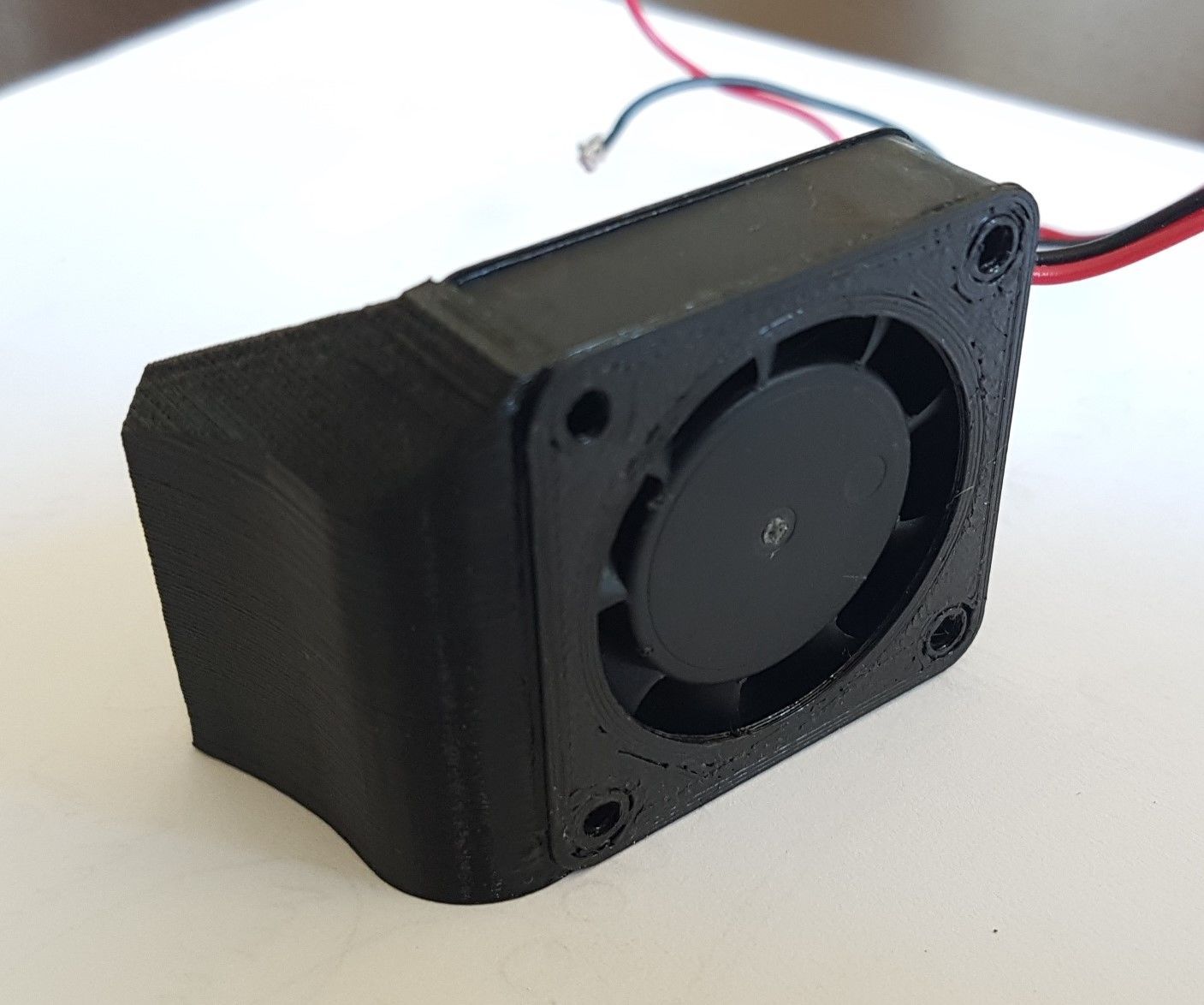

First you will print all the part in ABS or PETG. The settings are the usual, 0.4 mm nozzle, 0.2 mm layers, 25-50% infill, etc.
Because we have a crossflow fan, who cools down everything, we print the parts in black PLA. If it is somebody interested, I can design the RCServo extruder with support for hot end fan and filament fan.
Next you will make the servo motor to Mk7 gear adapter. This is a 5 mm diameter, 20 mm long stainless steel pin with 5 mm long M3 thread.
Press one bearing in extruder body. Next set up the extruder body, servomotor with 5 mm pin attached and Mk7 gear.
Press a 5 mm diameter, 12 mm long Al pin to second bearing and press to extruder arm. Set up the arm on the extruder body with M3 screw. Adjust the extruder spring with special M3 nuts.
Now you can glue the extruder wire support on top left extruder. I printed the extruder apart from wire support to have a good base to print the extruder.
Insert the PTFE tube into the hotend and then into the extruder and adjust the length of the tube to fit it.
