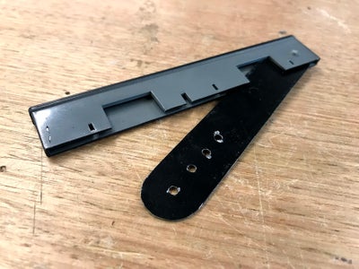

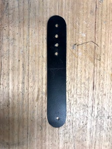

Step 4: Step 3: Building the Arm
The arm will form the main clamp in the concept, which will enable you to cut bottles in half.
This was created by first salvaging parts from the DVD player, such as the disk tray cover, then designing an arm extension out of the metal sheet to hold bottles in. As seen above, the metal sheet was used to cut metal parts as such which measures 12cm long and 2cm wide. The metal is somewhat thin and bendable, hence users in the future should be careful not to place too much pressure on it. The metal arm pieces were then drilled with a power drill and 3mm bits to create holes into the face. The arm extensions are also fitted into the disk tray cover by measuring holes where the arm extensions would rotate from, and this is followed by additional drilling, where a pivot point can be made from using metal rods (as seen above) cut and fixated with a round-headed hammer .
At this point of the arm's construction, you can paint it whenever you really want, though it would help to spray after all pieces are checked are perfected.
Part of one side's arm is also the blade, the main component used to cut into plastic bottles. The blade is created by sourcing from the DVD player's metal sheets, which is then sharpened against a metal grinder, sharpener and finally whetstones, where the blade was sharpened to a point where it could cut into skin very easily (I can confirm from first hand experience. The blade is then cut with tin snips into a triangular shape, where it is ultimately placed into the side's DVD tray cover.
Finally, with all the main components of the arm prepared, you can connect with the metal rod rivets, where conjoined sides will feature a beaten-in metal button to hold the arms together and use as pivots.
With leftover sections of the metal rod I used in the rivets to hold the arms together, I grinded one end into a sharp pin which could be used to poke a hole into the caps of plastic bottles, which would then act as the entrance for the wick in plant pots to transfer water into plants. The pin was superglued with a washer and also functions as the pin which holds the clamp together while bottles are being cut.

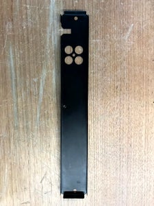

Step 5: Step 4: the Backbone
The Backbone of this project serves its main purpose of holding the structure altogether.
Of course, its key component is from the DVD player (the rear end), though extra materials are also used in the production of the backbone, such as 3D printed rods I used to improve the overall height and structural integrity of the concept.
The backbone does not require any additional help as it is able to keep all the stock together and on hand, and could be easily fixed by stripping the paint and welding onto the back surface of the main body.
After this, a spine consisting of the rods, washers and 3D printed parts was included to hold each arm, and fixed into the base through superglue. This part of the structure is held back by wires so it can stand straight up and the arms would not be bending towards one side, compromising the system's ability to cut bottles.
