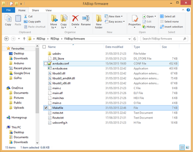

Whether you purchased this board assembled or in parts the chip is ALREADY PROGRAMMED AND TESTED so move on to the next step for using the device. If you have bought the parts and the chip separately and are building this from scratch complete the following steps to program the ATTiny. David A. Mellis wrote a very easy command-line makefile in order to program and fuse set the chip, i've packaged it alongside a solid version of AVRdude 6.0.1 to allow a super easy install and this is available here.

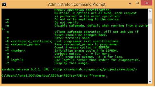

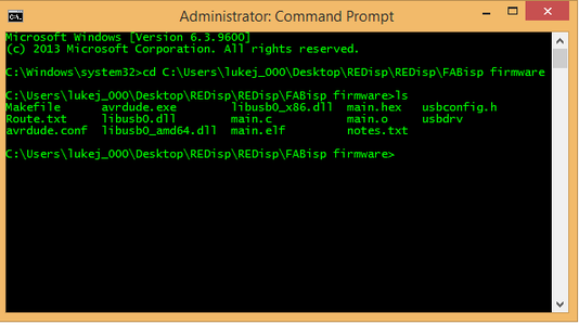

In order to use the system first download the folder Fabisp Firmware file from above and make sure it is all in one folder as shown in the photos. Inside the folder open the MakeFile (I used notepad++) and change the programmer to the one you will be using as shown above (AVRdude name). Using your chosen command line interface (CMD etc) navigate to the folder and first run "avrdude" to check its functioning correctly, then making sure the board is ready and plugged in via your programmer and that SJ1 is closed, type "make program" and watch the magic happen for 20 seconds. First it will write the code and then it will set the fuses. Programming done! unplug remove SJ1 now to avoid a long head scratching moment attempting to figure out how the ISP is giving you errors about programming itself....

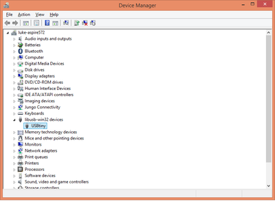

Next on all OS's check that a new device has appeared called USBtinyISP (after installing drivers for windows). In Device Manager on windows (shown), system profiler on mac and dmesg on linux.
