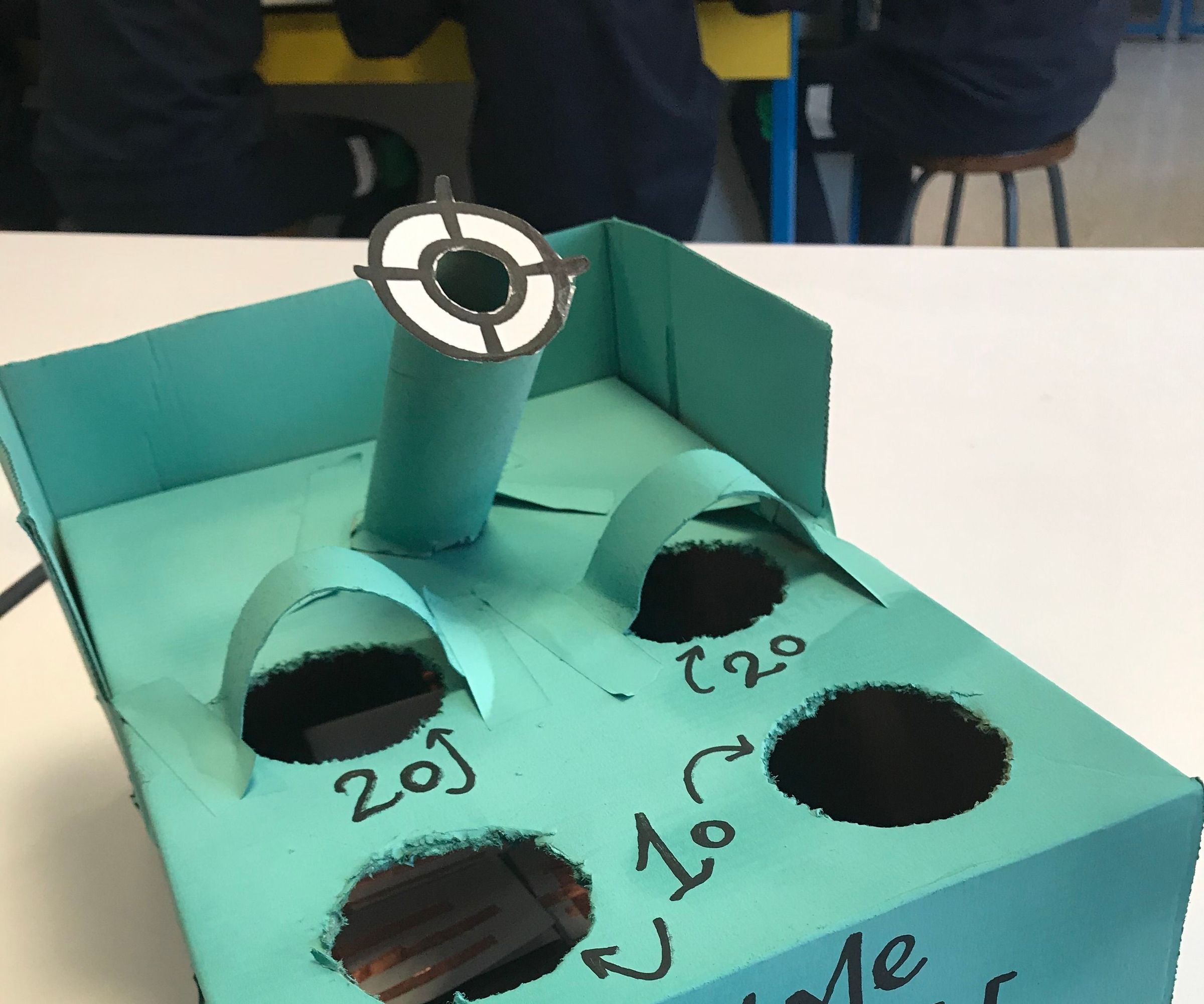

You will have to build two models, one for each participant. For each controller you will need a piece of paper or cardboard where you can fit the drawings or names of the four pictures you are going to use in your game (we have chosen: strawberry, bananas, tacos and watermelon). Then, paste the conductor button next to it.
