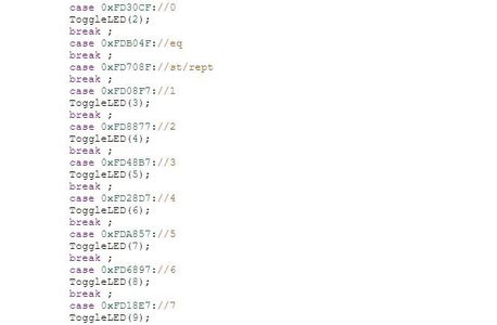

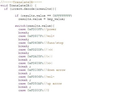

//-----TranslateIR-----
void TranslateIR() {
 if (irrecv.decode(&results)){
    if (results.value == 0XFFFFFFFF)
     results.value = key_value;
    switch(results.value){
     case 0xFD00FF://power
     break;
     case 0xFD807F://vol+
     break;
     case 0xFD40BF://func/stop
     break;
     case 0xFD20DF://|<<
     break;
     case 0xFDA05F://>||
     break ;
     case 0xFD609F://>>|
     break ;
     case 0xFD10EF://down arrow
     break ;
     case 0xFD906F://vol-
     break ;
     case 0xFD50AF://up arrow
     break ;
     case 0xFD30CF://0
     ToggleLED(2);
     break ;
     case 0xFDB04F://eq
     break ;
     case 0xFD708F://st/rept
     break ;
     case 0xFD08F7://1
     ToggleLED(3);
     break ;
     case 0xFD8877://2
     ToggleLED(4);
     break ;
     case 0xFD48B7://3
     ToggleLED(5);
     break ;
     case 0xFD28D7://4
     ToggleLED(6);
     break ;
     case 0xFDA857://5
     ToggleLED(7);
     break ;
     case 0xFD6897://6
     ToggleLED(8);
     break ;
     case 0xFD18E7://7
     ToggleLED(9);
     break ;
     case 0xFD9867://8
     ToggleLED(10);
     break ;
     case 0xFD58A7://9
     ToggleLED(11);
     break ;
    key_value = results.value;
    irrecv.resume();
