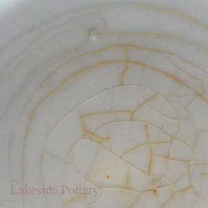

Step 1: What Are These Stains on Pottery? What Is Crazing / Crackles and Why Do They Happen?

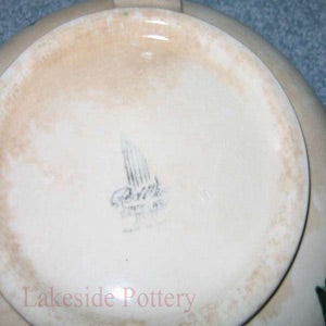

What are these stains on pottery?
They occur due to seepage of moisture through very small (and sometimes invisible to the naked eye) cracks in the glaze often referred to as crazing, crackle or pin holes in the glaze. The penetrated moisture combined with organic matter (Tea & coffee, oil, fat, food, dust, etc.) evolves into a bacteria that typically is brown or black sitting between the glazed craze lines or in the clay body under the glaze. Therefore, scrubbing the surface will not help. Bacteria stains are more likely to occur on earthenware or stoneware due to the ceramic higher porosity allowing the moisture to penetrate deeper and stay wet creating perfect enjoyment for bacteria to flourish. High fire ceramic such as porcelain, which has almost no porosity, will less likely stain.

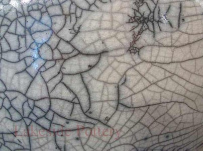

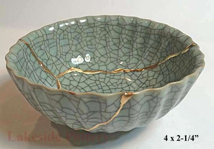

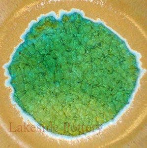

What is crazing / crackles and why do they happen?
They are a network of lines or cracks in the fired glazed surface. They usually occur at the end of the kiln firing process when the outside surface cools before the clay body under the glaze. Crazing can also happen during the vessel’s life time during rapid temperature changes (day/night, hot water / cold water, etc.). Often, for aesthetics reasons, the crazing effect is introduced by design and on purpose on Japanese, Chinese or Raku dishes or vessels – see examples above. More about crazing

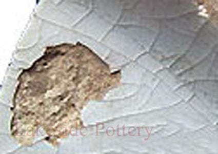

1) Do not use bleach or chlorine. Bleach or chlorine may remove the stains but also can damage your ceramic item as illustrated below.

2) Possible glaze flaking could occur (see above picture)
