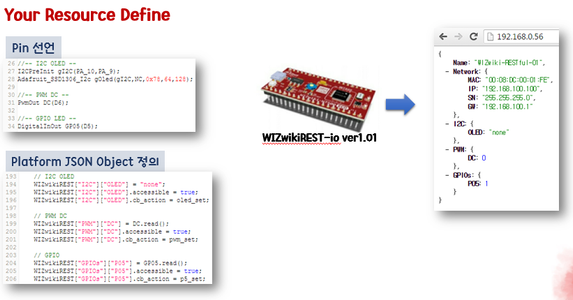

Step 3: Step 3: Define User Resource
2. Define user resource
//Fill the object
WIZwikiREST["Name"] = "WIZwikiREST-io ver1.01";
WIZwikiREST["Name"].accessible = false;
//Network
WIZwikiREST["Network"]["MAC"] = mac_str;
WIZwikiREST["Network"]["IP"] = ip_addr;
WIZwikiREST["Network"]["IP"].accessible = true;
WIZwikiREST["Network"]["SN"] = subnet_mask;
WIZwikiREST["Network"]["SN"].accessible = true;
WIZwikiREST["Network"]["GW"] = gateway_addr;
WIZwikiREST["Network"]["GW"].accessible = true;
// I2C OLED
WIZwikiREST["I2C"]["OLED"] = "none";
WIZwikiREST["I2C"]["OLED"].accessible = true;
WIZwikiREST["I2C"]["OLED"].cb_action = oled_set;
// PWM DC
WIZwikiREST["PWM"]["DC"] = DC.read();
WIZwikiREST["PWM"]["DC"].accessible = true;
WIZwikiREST["PWM"]["DC"].cb_action = pwm_set;
// GPIO
WIZwikiREST["GPIOs"]["P05"] = GP05.read();
WIZwikiREST["GPIOs"]["P05"].accessible = true;
WIZwikiREST["GPIOs"]["P05"].cb_action = p5_set;</p>In main.cpp, user can find JSON format resource defined. It is not hard.
In here, user can define the URI, and decide it is acceptable or not. It means the value can be changed by URL.
If you set ".accessible = false" , none change the value. WIZwikiREST["GPIOs"]["P05"] = GP05.read(); ["GPIOs"]["P05"] is like direction to approach the value.
So, if user want to change the pin 05 value, user need to type " xxx.xxx.xxx.xxx(platform ip)/GPIOs/P05/1 (or 0) "
And GP05.read() is initial value. Also define value type.
so, the value will be integer type. It means, user need to type int value when send URL data. At the last, ".cb_action" is the callback function.
