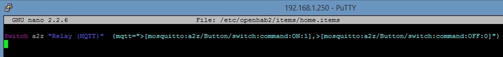

OpenHAB configuration
The following changes are required to OpenHAB:
'items' file:
Switch frontdoorTrigger "Front Door" (gDoors) { mqtt=">[mqttbroker:openhab/frontdoor/trigger:command:ON:LOCK],>[mqttbroker:openhab/frontdoor/trigger:command:OFF:UNLOCK]" }
Number frontdoorStatus "Front Door [MAP(status.map):%d]" (gDoors) { mqtt="<[mqttbroker:openhab/frontdoor/status:state:default]" }
'sitemap' file:
Switch item=frontdoorTrigger mappings=[ON="Lock", OFF="Unlock"]
Text item=frontdoorStatus
'status.map' file (in transform folder):
0=Down
1=Alive
-=unknown
You may need to change the above OpenHAB configuration slightly to suit your own setup, such as the "mqttbroker:" part which refers to your configured MQTT broker name.
