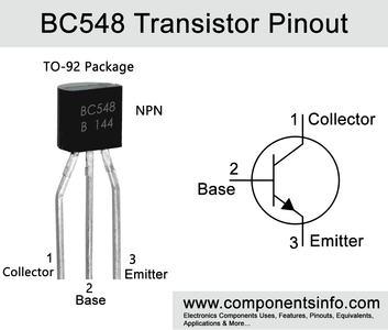

Linker Transistor (Zifferntreiber): BC548. Der Eingangstransistor rechts sollte BF199 sein. Bitte auf Pinbelegung achten!
To ensure compatibility of PCB and Schematic, pay attention to the jumpers in the figure. The reason for this is that, while it is driven by the 5th Digit transistor in the original design, it is driven by the 1st Digit transistor in the WU3WJM's design. It has been modified to ensure compatibility between the firmware and the PCB.
Digit driver Transistor in left side must be BC548. Input Transistor in right side must be BF199. Please pay attention to Transistor pinouts!
