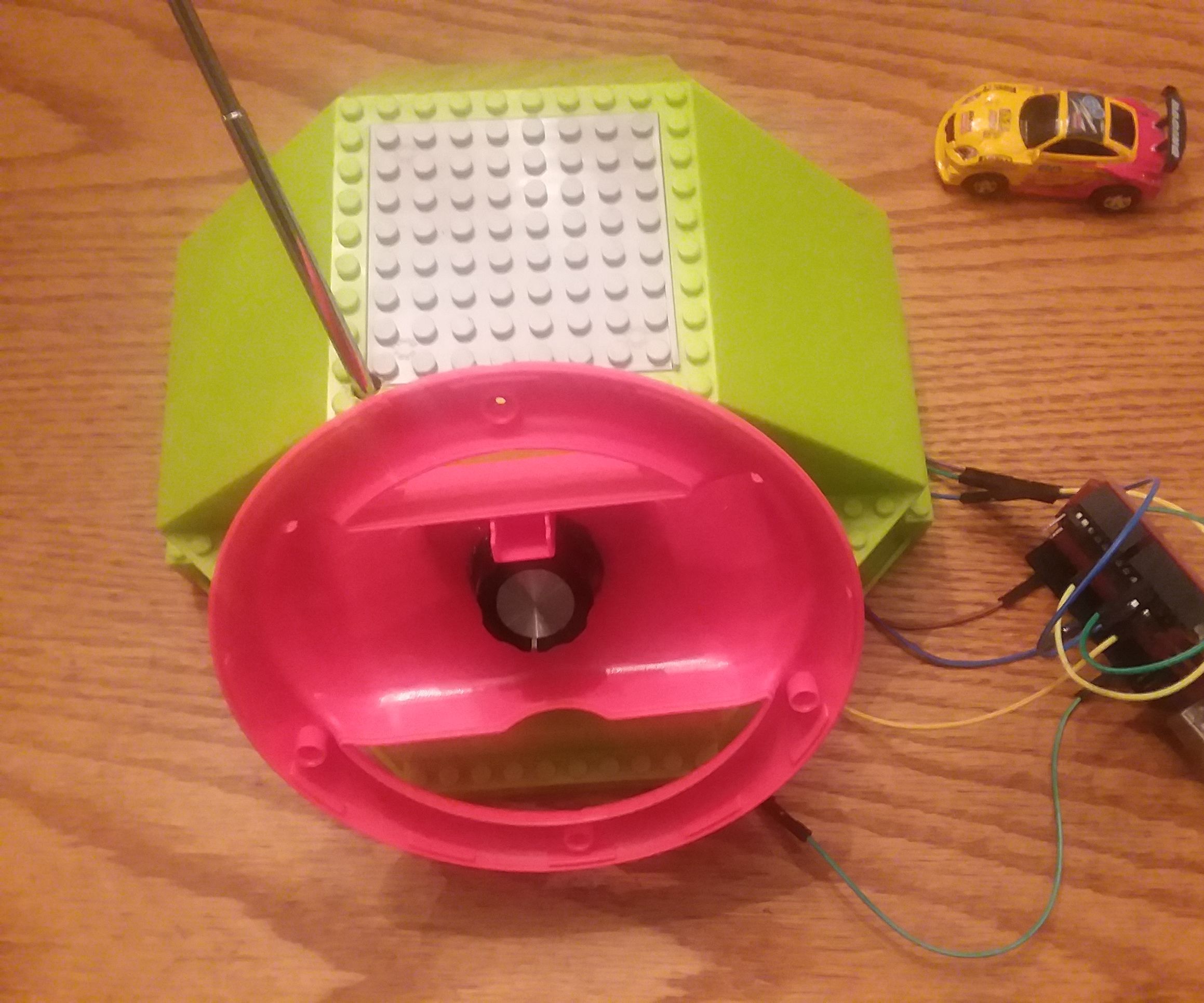

I wasn't able to put it on the inside then have the antenna just stick out cause the NANO was on the inside already.....
The antenna used in the pic is from an RC car controller. Jumper wire still works the same.
