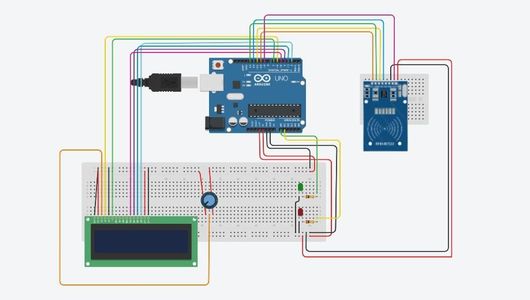

Step 1: Wire the Reader
Follow the wiring diagram above.
If you want to include any special parts like a servo or a speaker add those in now.
Feel free to edit and change this diagram in any way you want!

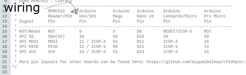

Step 2: Find Your Cards UID
Before your card can be recognized by the reader, the reader has to know what to recognize. To do that we have to find the card UID. UID stands for unique identification, and it is 4 sets of 2 numbers and letters (example: xx xx xx xx), and you have to use the rc522 to find it. Below are the steps to finding your UID:
  1. install the rc522 Arduino library, called MFR522V2 (GitHub link)
  2. open examples and click on rfid_read_personal_data
  3. Unplug the rc522 from your previous wiring and rewire it following the instructions at the beginning of the code. There are different instructions for different boards so pay attention.
  4. upload it to your board and open the serial monitor.
  5. Hold up your card to the reader. You can use the tag that comes in the package, or a stolen hotel card. However, if the hotel card is a low-frequency card, it won't respond because the rc522 is a high-frequency reader.
  6. Then you should see a line that says "Card UID" It's probably a good idea to write this down. Note that in the name section, it says "authentication failed" this isn't super important, but if you want to have a custom name for your card you can change it with the rfid_write_personal_data example found in the same library.
WRITE DOWN THE UID. YOU NEED IT FOR THE NEXT STEP.
