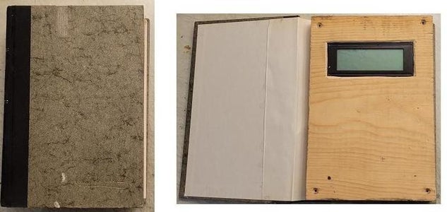

This clue was placed inside of a mini free library next to a fire station in a small town that the treasure hunt would be passing through. It needed to blend in with the rest of the books and not draw attention to itself. I chose a book that has sustained some water damage and the pages were all stuck together to make this. Relax book fans I didn't trash a perfectly good book.
The pages were surgically removed leaving the cover intact enough to pass muster as an innocent book on the shelf that isn't that interesting. A wooden insert was created to take the place of the pages and glued in place. When the book is closed and sitting on the shelf, only a very close inspection would show that this is not really a book. When opened, you are greeted with a blank page with a blank LCD screen. When a magnet is waved just below the LCD screen the unit starts up and the instructions to use the unit are displayed. When a RFID object is waved over the sensor then a pre-programmed message is displayed on the LCD screen. The message then goes back to a "present RFID object" screen with a 10 second count down. When the count down completes the unit shuts down to save power.

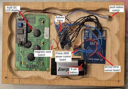

You will need:
1 donor book at least 5 1/2 x 8 x 1 1/2 thick
1 Arduino Nano or clone
1 Pololu 2808 power control board
1 4X20 lcd display with I2C backpack
1 RC522 RFID board
RFID cards 13.5mhz AMAZON
9 volt battery with adapter
1 push button micro micro switch (6mm x 6mm x 12mm)
1 magnetic reed switch

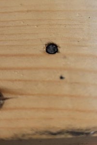

You will need a donor book that is at least 5 1/2 x 8 x 1 1/2 inch thick to be able to fit everything in comfortably. You can go smaller if you are thicker but I have found that this is the best size for this project. Very carefully using a razor knife separate the pages from the cover. If you can leave the thick front cover page and the thick rear cover page it will give you something to glue your wood block to. The insert is made up of two pieces. Only the lower one is glued to the book. The top one is screwed to the back by a screw in each corner.

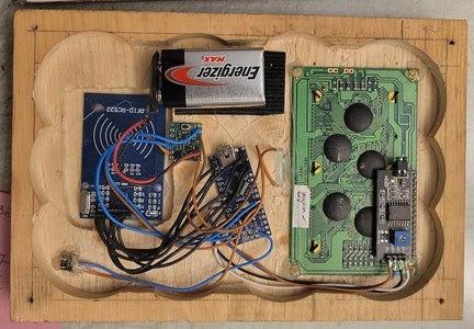

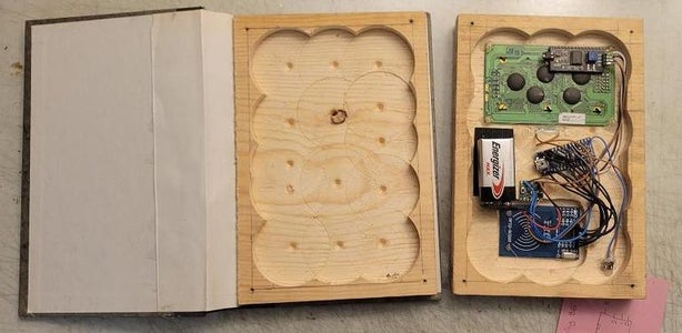

The wood that I used was two pieces of pine 5 1/2 x 8 1/4 x 3/4 thick. They need to be flat and free of knots as you will be drilling out the center of the boards. You can also use fiber board. I chose the pine as a quick glance make the grain of the wood look like pages but use what you have. As you can see in the picture I used a 2 inch forstner bit to hollow out the front section half the thickness of the board. I did this with the rear section as well. This created a void inside the sandwich of the two boards of about 3/4" +/-. Using a router I further removed the cavity that the RFID board sits in that puts about 1/8 of an inch of wood between the sensor and the front of the front piece. I found out that any more wood than that and the sensor had difficulty reading the RFID objects. The LCD display has a rectangle hole cut all the way through so the LCD sets just below the surface of the face of the top board. I had plans of laminating a piece of paper over the top of the face but ended up printing a sticker to place over the face then cutting out the LCD screen. You will also note that there is a micro switch that is glued into the bottom corner of the void. This also is all the way through and also sits just below the surface of the face piece. if you cover the face with paper it will cover the location and the existence of the button to the user. Then you can use a sharp pin to press the button through the paper if you need to reset the unit.

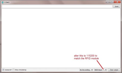

Second you will need to change the baud rate of your serial monitor to 115200 for that is the speed of the RFID module.
